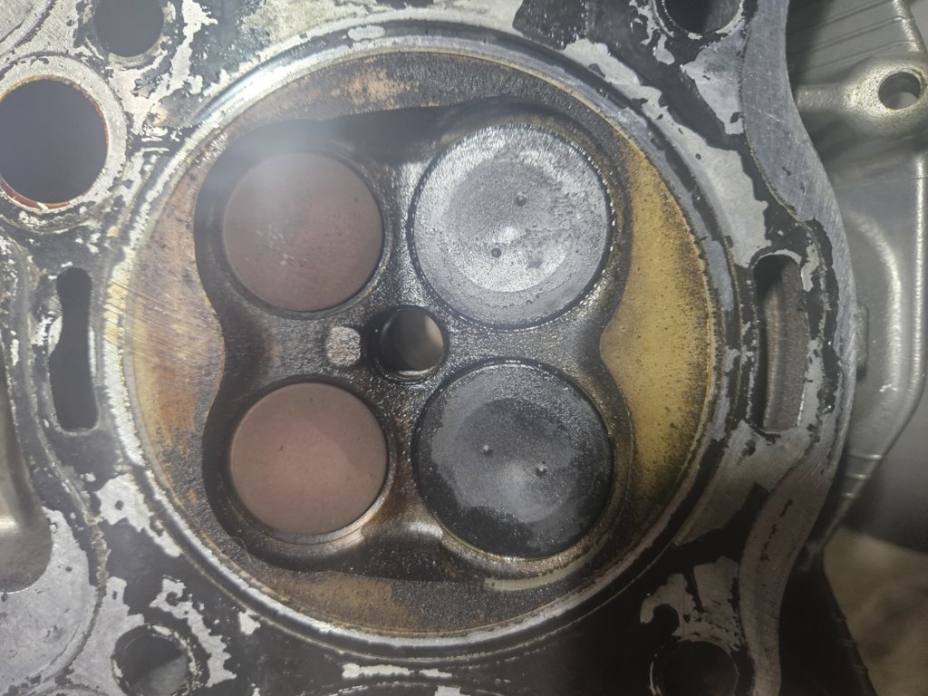

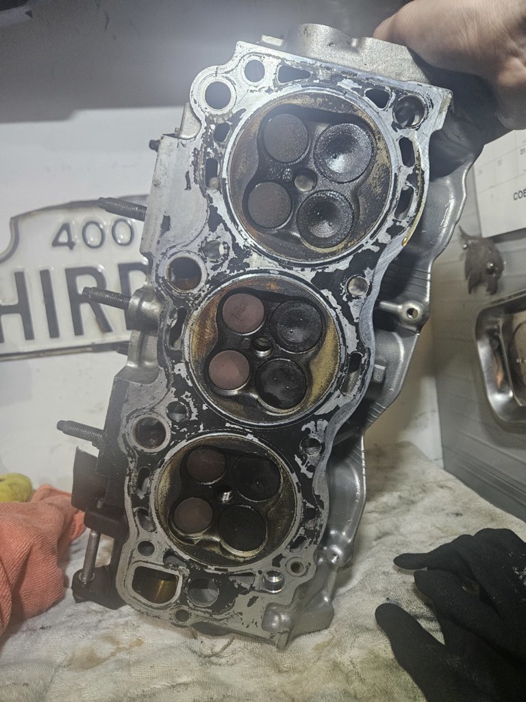

    Got both heads off. This is the cylinder which had low compression. Nothing extremely obvious jumping out so hoping it was just the head gasket and not a crack in the head or anything.
    Will have it pressure tested, decked and valve job on it. I am also in the middle of a 5 speed and 4x4 swap so this was just the icing on the cake.
