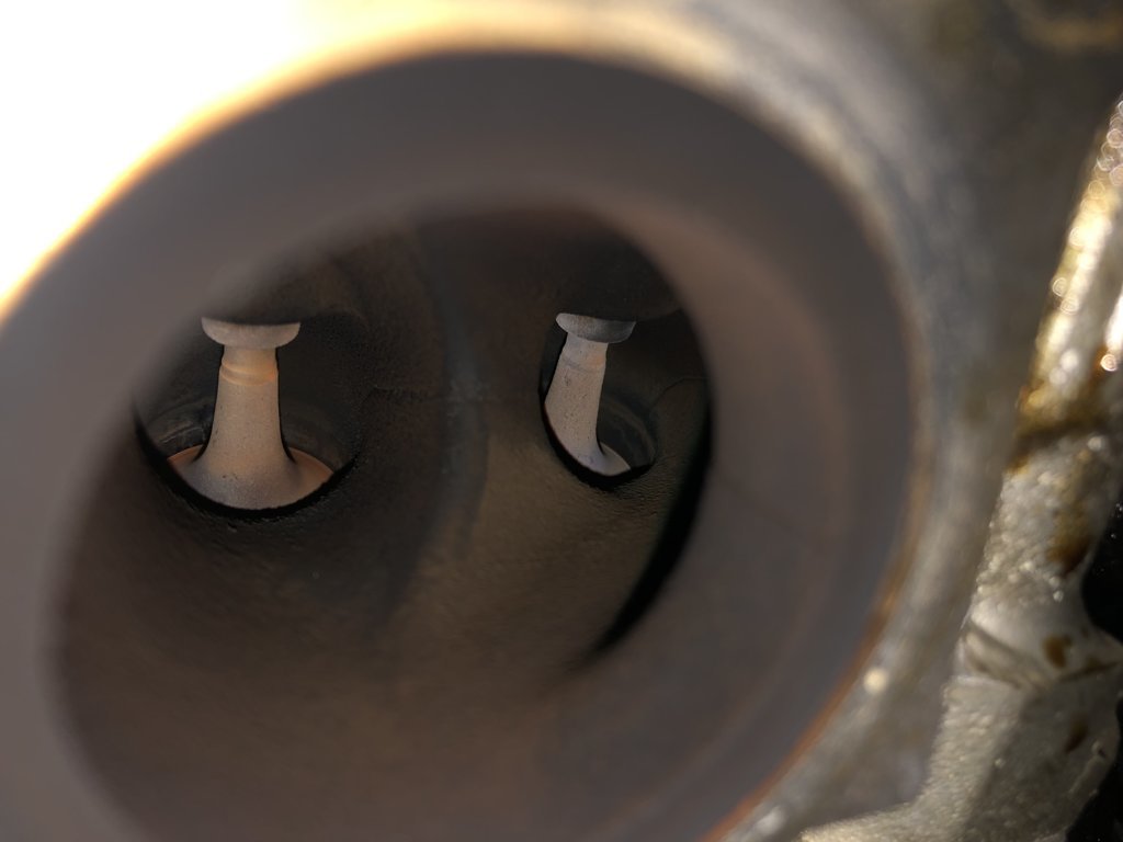

    Cylinders 1 3 and 5 exhaust side. 3 has some crap in it, and 5 looks overheated.

    are those cracks at the bridge between the valves or just a normal seam?
    My point was to do the decor before tearing down, sometimes could be an easy fix. if valves are hanging open & not seating correctly but looks like youre going all in...

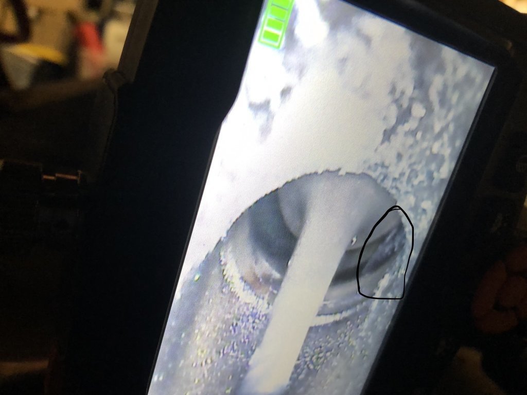

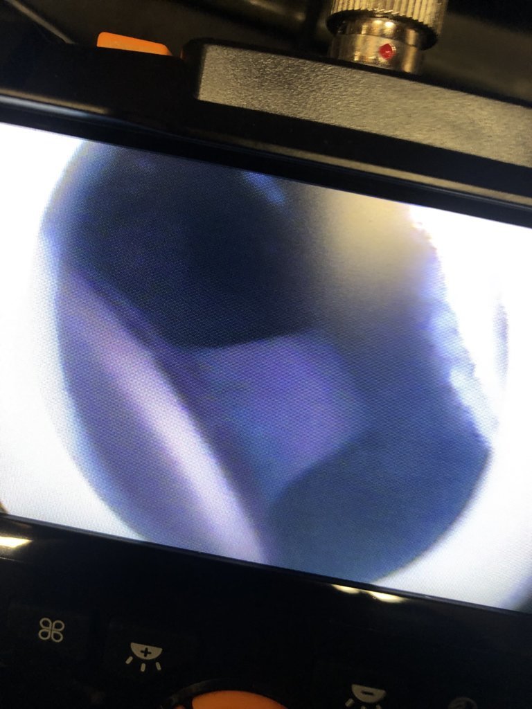

    looks like a chip in one of valve sealing areas, and head gasket material in zoomed out photo. These borescopes are nice. Shoulda bought one years ago.

    I cant say that I see anything youre describing in the pics & I did engine work for a living...
    im not saying youre wrong, just dont see it..
    ide also be looking at the inside edge of the cylinder walls for severe vertical scoring,
    Thats always an indicator that teardown will be a waste of time & resources...

    Yeah my eyes don't see what yours does, pictures of a screen rarely come across clear it seems, for me anyway... If you think you can see the head gasket, well then the head has to come off anyway cause you should not be able to see the head gasket poking out... lol
    The 2nd pic, still can't see it clearly, looks like a carbon flake...

    4x
    Can you elaborate on what you think you see in the pics?
    Not seeing anything....

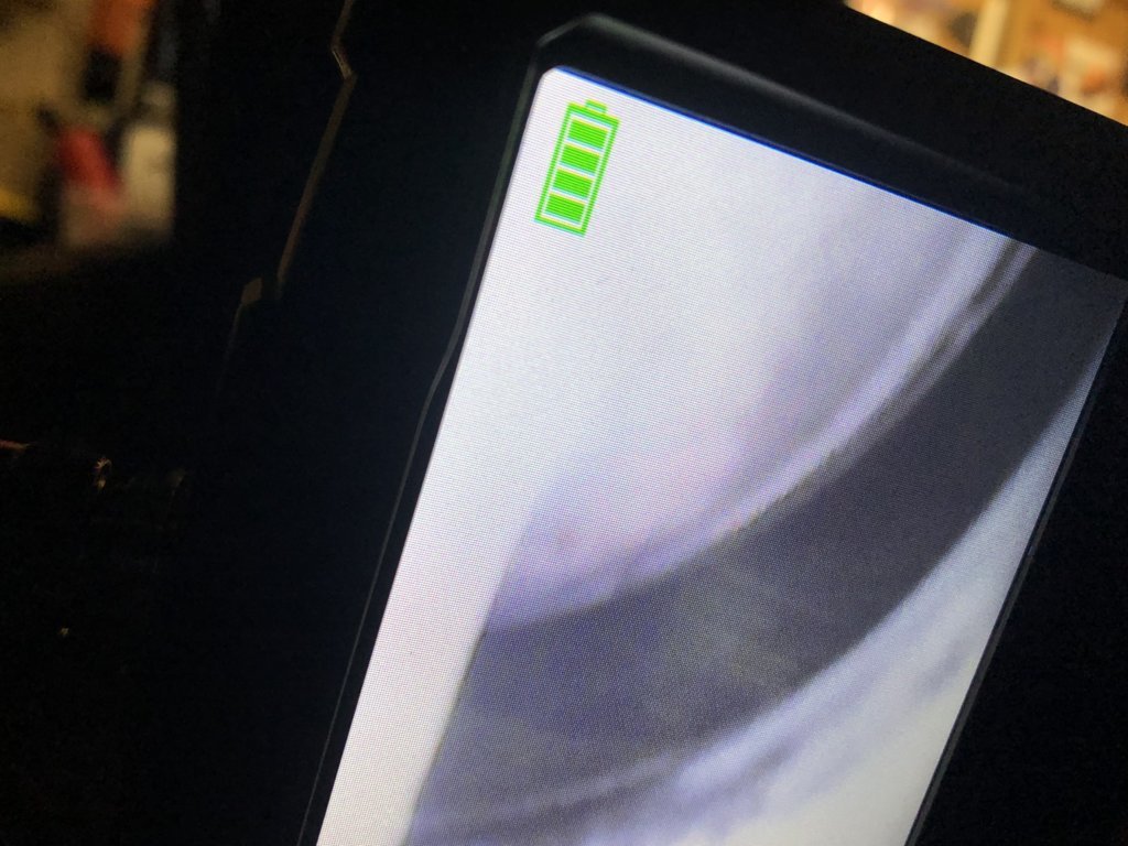

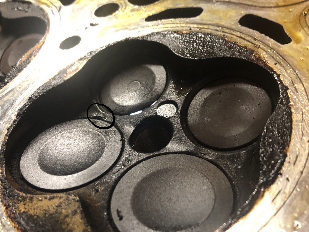

    Not sure what this little whatever is?

    Looks like carbon to me, I am guessing though that is what the OP described as head gasket...

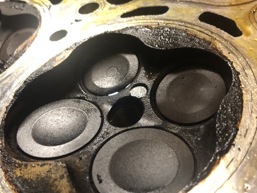

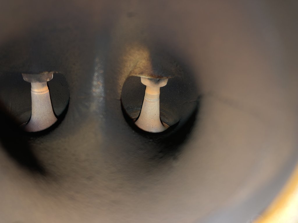

    burnt valve one on top. I have a light in exh port you can see valve stem.
    those flakes were indeed carbon on cyl wall edges up top. Cyl looks good all honed marks still there.

    Yep, time to send both heads out for a deck and check and valve job with new valve(s)...
    You can install the spark plugs and then pour some gas in the 5 remaining combustion chambers to see if any more valves are leaking, the one with the burnt valve won't work due to it already leaking, but check the other 5 cylinders...
    I wouldn't mind seeing a good picture of all 3 chambers together for each head...

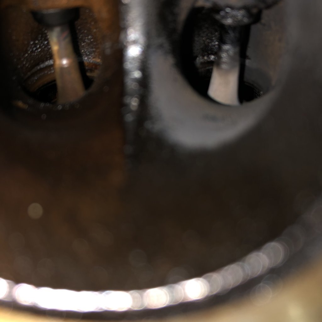

    LED Bed lights, gas cap holder, MA1 W/ 90 degree connector, Drop Step Running Boards, Console Tray (Red Trim), Cup Holder Insert Kit (Red Trim), Head Rest Hooks, LED interior lights, Dog Hammock, rear door protectors, LED reverse lights (now VTAILs), black tailgate inserts, blackout badging, color matched glovebox letter inserts, VTAILS, H9 low beams, LED tag lights, bed mat, tailgate mat, Tri-fold soft Tonneau cover, Pro grill (OEM), AVS In-Channel Rain Guards (smoke),
    Carbon goop... Need to clean up really good, or just take them to the machine shop and they can do any repairs needed...

    they have to visit the machine shop, you dont just want to throw a valve at it....
    way too much work at this point to play games...
    a good machine shop will put good parts in it, & get rid of the budget garbage the engine rebuilders used...
    hardened valves & seats...
