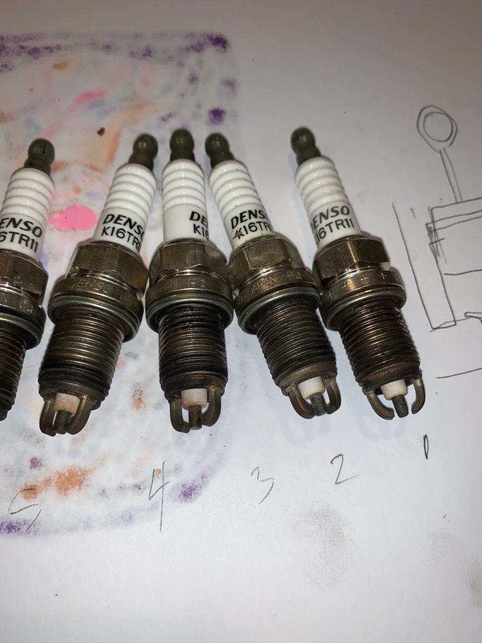

    Decided to do a tune-up on it this weekend (yay CV19), and replaced the fuel injectors, plugs, o2 sensors, etc, and while I was at it, decided to run a simple compression test. Don't know the cylinder order yet, but all the cylinders got 205-210 psi EXCEPT for the frontmost cylinder on the passenger side, its pressure raised more slowly than the rest, and topped out at 175!
    I figured it would have a different spark plug than the others, but they were all about the same color: Nice & tan, with no wetness, no cracking, no heat burns. All looked nice.
    Obviously, the bad compression would be rings or valves.. given that the other cylinders are all at 205+, and assuming all the rings were put in at the same time, I'm assuming it's NOT the rings (why would one wear faster, unless it is cracked?) and therefore must be a valve sticky issue. Anybody see this on that particular cylinder? I've actually not run across this in a car (truck!) before!

    The one that had the low compression is on the right...

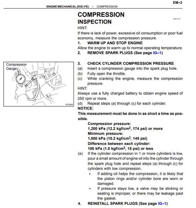

    eric

    250k miles? 175 psi sounds pretty good.
    I think the min in FSM is like 145 or so.
