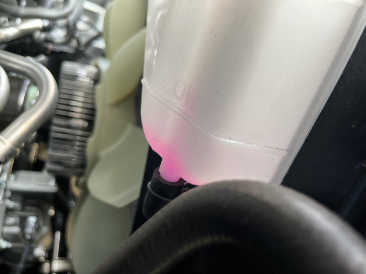

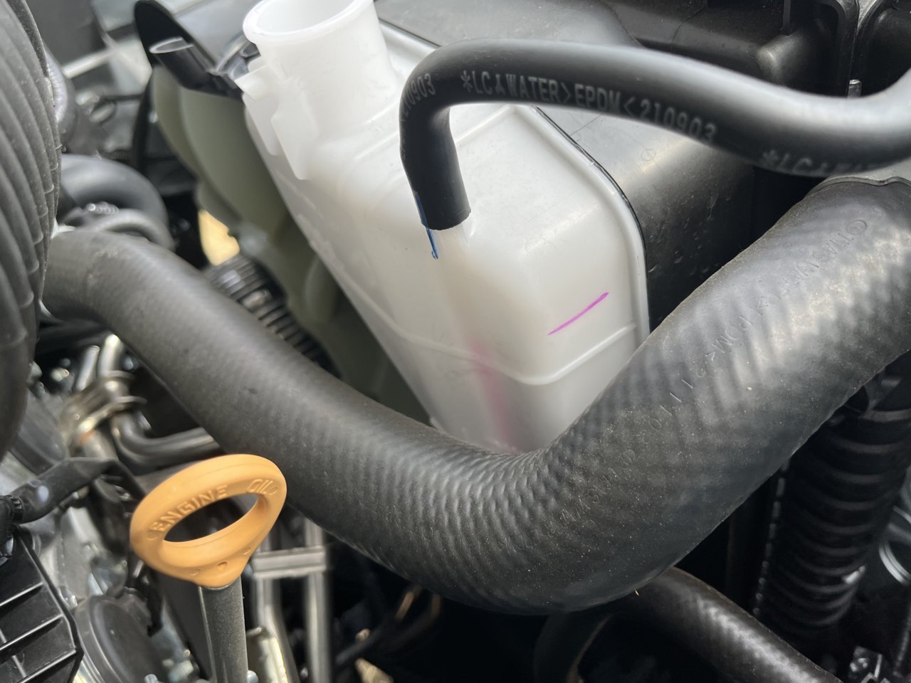

    Hey guys,
    New to TW and Toyotas in general! I just got back from a 200 mile road trip.
    Checked all my fluids the next day and found my coolant reservoir empty. I did not check it since I bought it. I’ve had it for 4 months about Now and has 4000 miles on it. Seems to be running fine. I will probably just too it off and watch it.
    If it falls low again I’ll bring it to the dealer for a coolant system pressure test. Anyone else have this issue? Also I had to top off my transmission and rear diff fluid as well from factory. I was having loud clanking noises from my transmission and my rear diff seemed noisy. Both have been remedied.

    Fill it and keep an eye on it.

    If you’re able, check under your truck for any signs of the pink coolant. I had the same thing happen to me and found out the coolant pipe on the back of the engine was leaking. Everything ran fine and no other signs. Just a suggestion since it just happened to me a few months ago.

    Was it a steady dripping from the hose?
    I have no leaks when it’s running or sitting. My guess is it was like that from the factory and nobody bothered to check it. Either that or it’s burning coolant which is very unlikely since it’s a brand new 3.5 motor.

    It must have been and when I crawled under the truck and shined a flashlight in every nook and cranny, I found a big mass of crusted coolant all over the bypass pipe. Was probably a fine crack that was leaking for who knows how long. But you’re probably right about being low from the factory cause my truck is a 2017, yours is brand new.

    Could be just from factory under filled
    When the truck is cold, add some pink stuff to the reservoir cap, not the radiator cap.
    drive the truck for a couple of days and check, if still low, repeat.
    If there's no leak and no burning coolant, you should soon reach a point that the level in the reservoir stays between cold and hot and stay there.
    If you have to repeat again and again, then something else is going on.

    Hoping this is a one time fill. Thanks for the info mate. I wonder if they fill it to the line in the factory and then it lowers as empty parts of the coolant system start to decavitate as coolant moves in. I noticed they did put a fill line from the factory that was even higher than the max level. They probably fill it higher at the factory and then it lowers. The dealer I bought it from is a “as is/no negotiation” dealer. From what I’m seeing with having to top off my fluids this dealer did not do the pre inspection. They probably don’t feel the desire to check any of the fluids, so crap baskets.
