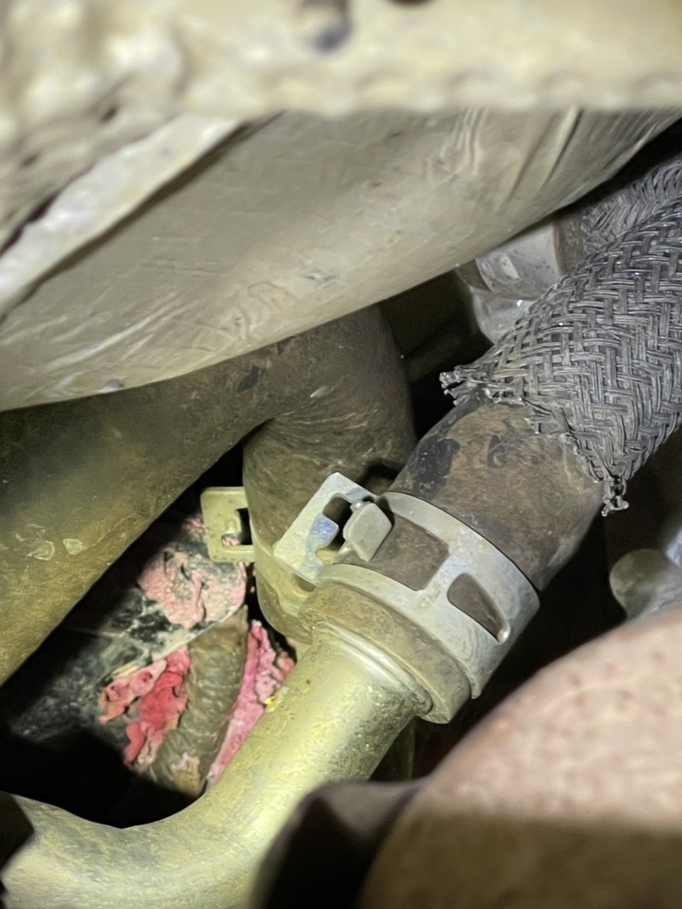

    So here’s the only good pic I was able to get. This is from underneath the truck, passenger side looking towards the drivers side, rear of engine. Best way I can describe it. If you look up where the coolant bypass is located, you can crawl under and look in that direction and probably find it. 15E95BA3-9E27-41CA-A66D-2043A32E3EBC.jpg

    Thank you!:1up:
