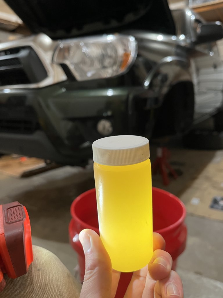

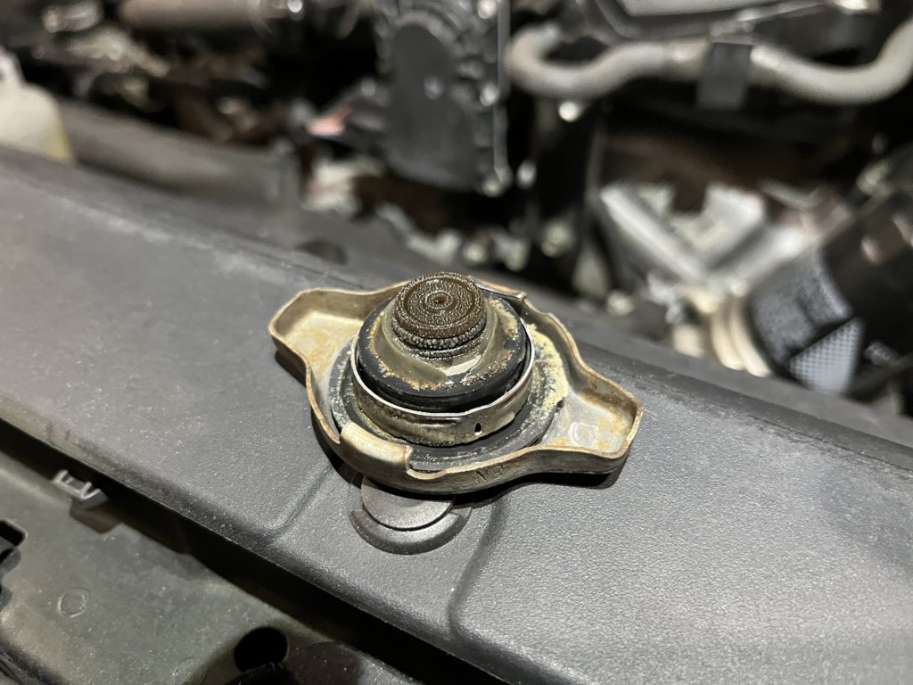

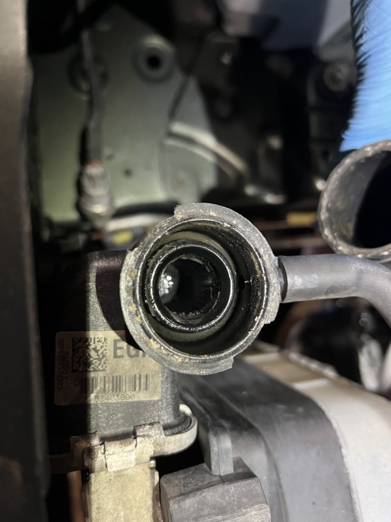

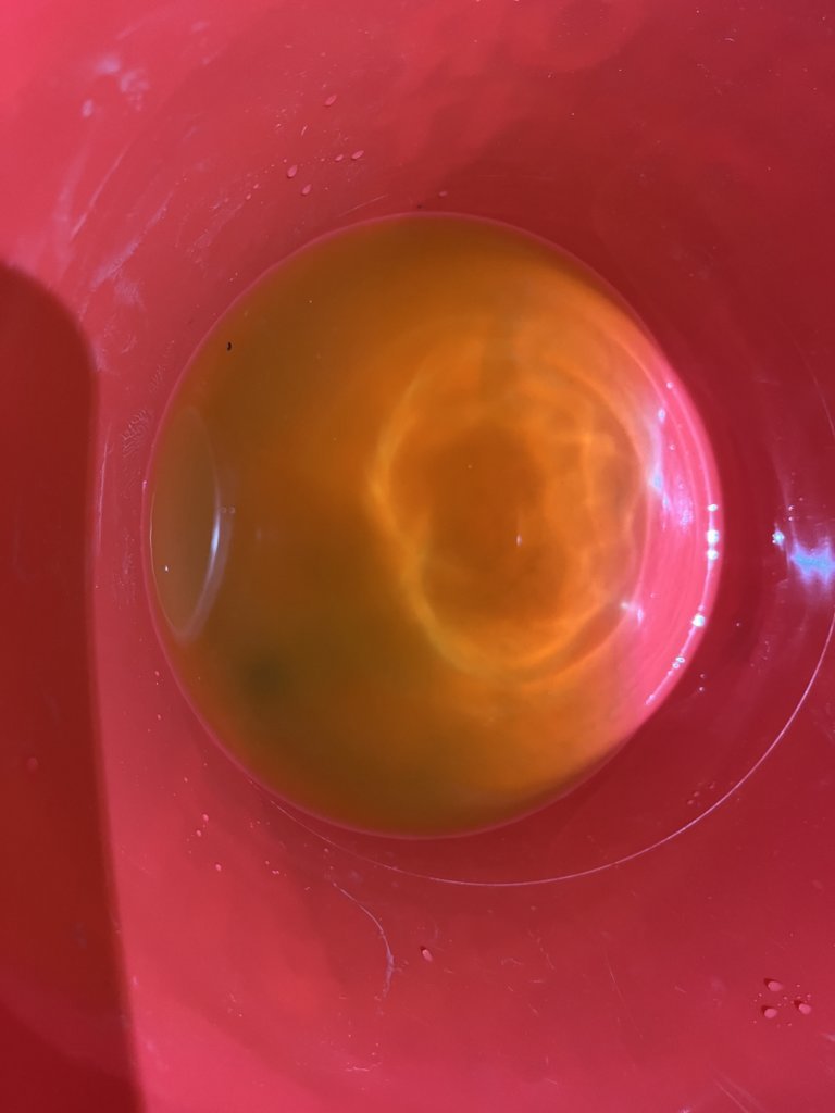

    Looking for opinions on next steps here. Pictures below are what I found after draining coolant and popping the cap off. Maybe a quart or so came out of the radiator drain (dead cold - a bunch still in the block maybe?). Coolant reservoir has some “tub rings” in it but no coolant.
    Was running fine and not overheating; but I've put about 2,000 miles on it since I bought it in June. Maintained its entire life at a single Firestone location in the Denver area, one owner, gave me all the records; coolant done on schedule at 100k and 150k, now at 199k - well maintained but not exceptionally/OCD grade. No mention anywhere about overheating, low coolant, or sealants - but, wouldn't be hard to "forget" those records, especially if it was an emergent issue and didn't come up in routine maintenance. PO seemed like a very good, up front guy..then again; was also an attorney, so there is that. o_O Either way, it’s my problem now. Had a Blackstone test done when I got it home and oil-wise, it was clean. Coolant is murky; but not chocolate milk. No visible leaks anywhere.
    So, I was originally going in to tear it down to refresh everything, new radiator, seals, the whole shebang and thought pulling that rear crossover to replace the seals would be a lot easier with the transmission out (getting ready to do the clutch while waiting on my front end parts to arrive). Looking for some input as my strategy may need to change here. My current thinking as far as options:
    1. Crack open the block drains and hopefully get a lot more coolant; refill with distilled water and flush it out with a bottle of IronTite ThoroFlush I’ve got kicking around from my last (much older, iron block) project. Then buy whatever tools needed to vacuum/pressure check things for further diagnosis.
    2. Stop everything and get the vaccum/pressure check tools.
    3. Stop everything, and send a coolant sample out to see what’s going on there.
    4. Combination of 2 & 3.
    5. See if TacomaWorld has seen this before, and already knows my head gaskets are done for and just plan for that job too while the Black Friday dealer sale is on (silver lining).
    6. Set it on fire and drive it off a cliff?
    Thanks in advance…

    Scares me to touch these things but with all the suspension out the access is pretty good so I cracked the block drains. Still a bit concerned about the lack of coolant in the radiator - got way more out of my Subaru 2.5's radiator when I did it a couple weeks ago, but feeling a bit better. Vial sample is from the very last drops of the block drain, realized everything else went in an oil pan so if I want to test that wouldn't be any good! Doesn't look as bad as what came out of the radiator; may have just been some settled crap at the petcock.

    Looks like they were using some kind of "universal" coolant and probably tap water (thus the deposits), definitely not Toyota Pink and distilled water.
    It holds about 2 gallons total.

    A radiator only drain gets about 3/4 to 4/5 of a gallon.
    Only a quart came out? That sounds low for sure.

    I'd toss a new radiator cap on too, that one looks original.

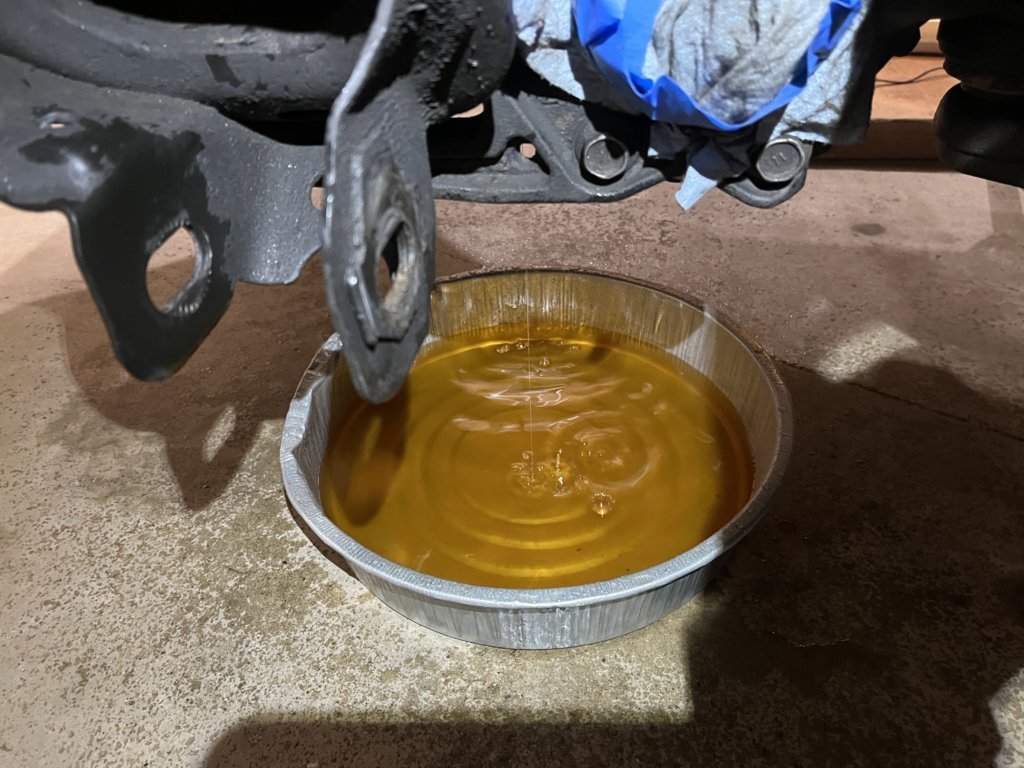

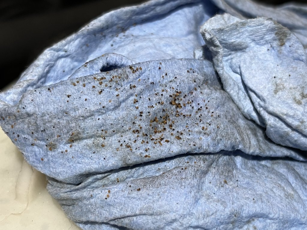

    Spent some time cycling distilled water through today. Must have had an air pocket, couldn't get any heat out of it and the lines weren't very warm; but I pulled the hoses and blew some air through both ways and then dumped water as well with no apparent back pressure through either the core or the lines to the engine. Wound up just looping them at the core area, my last jugs of water finally got them heated up at least (is there any sort of valve on this system that was maybe stuck?).
    I was watching pH though after the second round and it was weird; the water I drained was alkaline, 8.5+. I then checked the water going in (store bough steam distilled), which checked in around 5. 2-3 more cycles and I expected it to come down but it just hovered at ~8.5. I then adjusted the "fresh" water down, eventually as low as 3.5-4; same results. I got the same numbers with a color changing dye and a digital meter, wondering if something was off.
    Every drain though, I was getting some of this brownish-reddish particulate in the bucket out of both the block drains and radiator. Does this look like anything recognizable?

    I don’t recall anything like that coming out of mine?
    But then again, I drained mine in to a pan. Dumped it in a gallon jug and never payed anymore attention to it.
    I check mine for the freeze point.
    Other than that, I don’t check anything else.
    I just change it every 5 years.

    Just spitballing here and I’m very much an idiot, so take this with a grain of salt.
    Maybe the silicates breaking down and dropping out of the coolant?
    Was one of the major failure points for the 6.0 powerstroke.

    Yeah I'm more just curious if I'm seeing signs of something previously added to patch up a problem, or if that's just normal "stuff" in high mileage cars. I'm doing a TON of work in addition to this so I'd hate to get bitten in the ass 6 months from now when I was already 40% of the way to XYZ and have another vehicle to drive and a garage (may be my only car in the next 6-7 months if I go back to school & apartment life).
    Going to leave the cooling system intact for now until the pressure test stuff shows next week.
