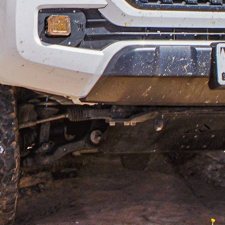

    A second vote for BP Fab. We have it, it's plenty strong. Hangs down a bit, so we've hit it on trails, but that only marred the powder coating.

    Does that BPF Recovery point work with most aftermarket skid plates? i've got a BAMF front plate.

    I believe it's more a question of the bumper. The skids should mount right below the recovery point, but some bumpers cover them up.

    Gotcha. I'm running a stock front bumper.

    If you can see the tie-down loop on the driver's side, the recovery hook will mount fine.

    Shitty pic having to zoom in so much, but here's the BP Fab hook with stock bumper and Pelfrey front skid. We have actually used it a couple times.
