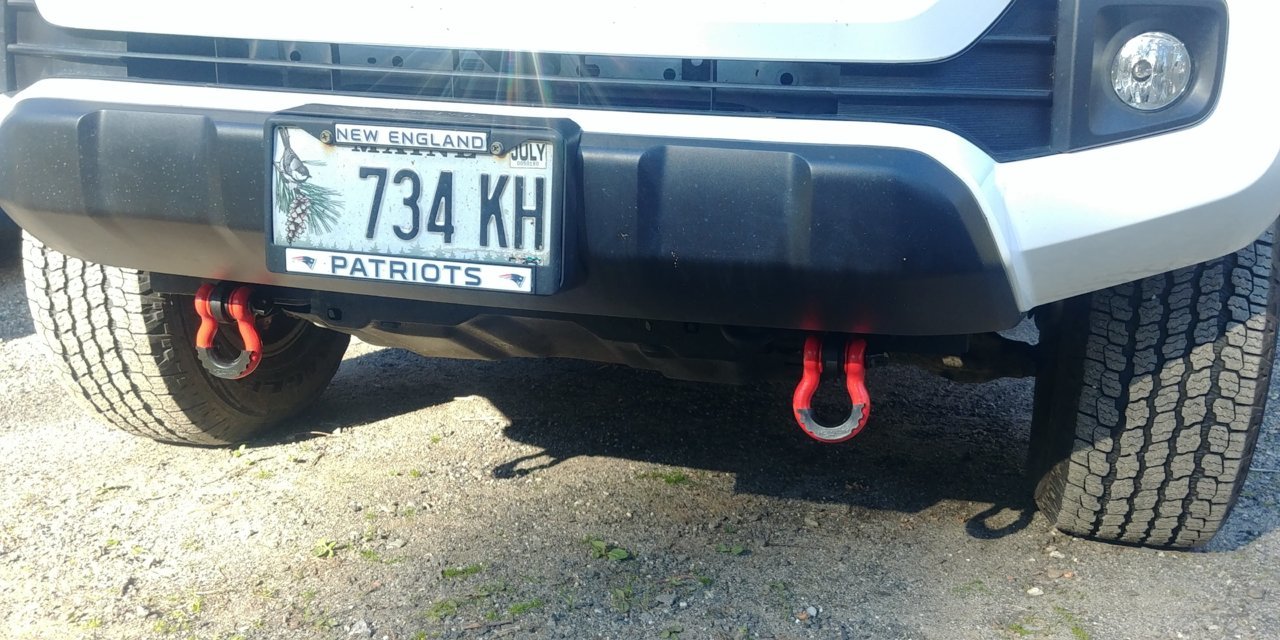

    I bought demon mounts and some shackles. Demon mounts from here:
    https://amistyling.com/demon-brackets-toyota-9-19-tacoma
    They seem to be solid. Haven't had to use them, yet.

    I like those! I think I may get a set of them. What do those attach to?
    Can you also link me to the red shackles you got with those?

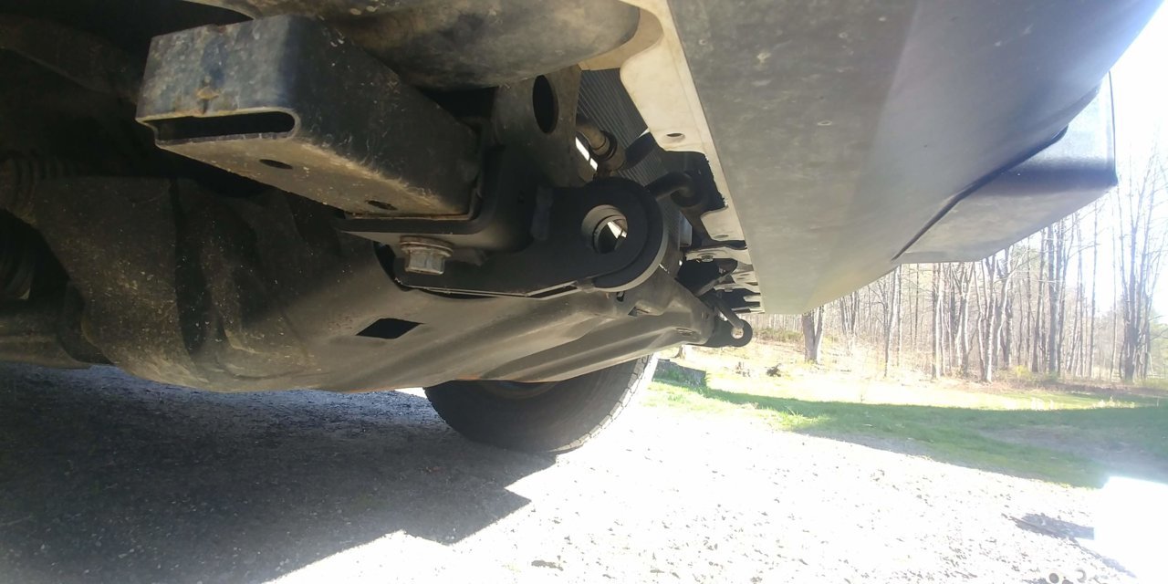

    They attach to the cross member that the factory hooks are on. Reuses their bolts. I got these shackles:
    https://www.amazon.com/gp/product/B07NMTVDNH/ref=ppx_yo_dt_b_search_asin_title?ie=UTF8&psc=1
    I did have to do a little trimming of the nylon washers that came with the shackles. I used a knife to trim. They fit tight on the demon mounts with the washers. But the washers keep things from "clanking."

    Thanks Brownie Man! After having them how do they hold up to weather? Any surface rust or anything?

    They have been installed since May 12th. No rust that I have seen. Powder coat seems to be holding up.
