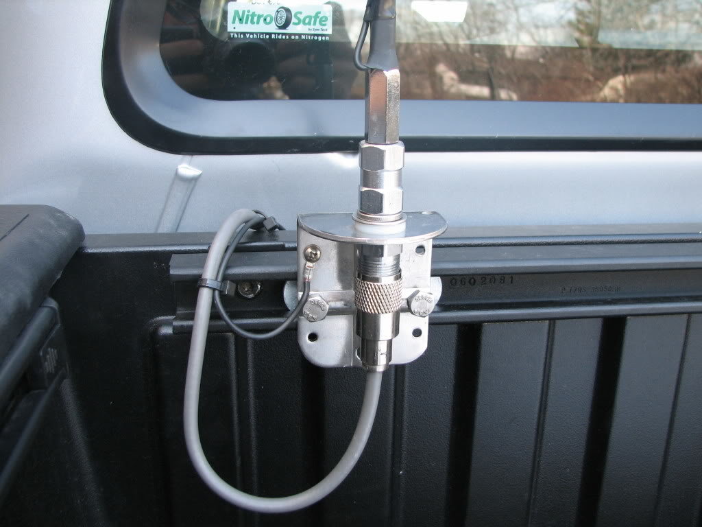

    Plan to mount it like this (Google find). Looks simple enough. Although probably on the side further back, not up by the cab like that.

    OP, It looks like you are getting the SWR meter with that package, which is great.
    I just installed my 4runner CB setup this evening. Uniden 510XL wired directly to the battery, 18' coax, door jamb antenna mount between the tailgate and bed post, and a Wilson Flex 4'. I grinded the paint off the bed post behind the antenna mount. I hooked up the meter to tune it and it read 1.1:1 on channel 1 and 40, and 1.0:1 on channel 19. I did not even have to touch the tunable tip.
