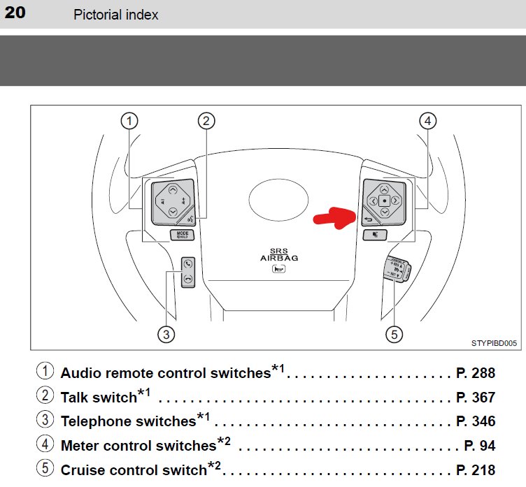

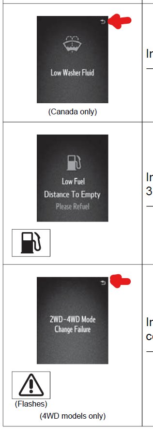

    This button. I believe that button to clear the warning is shown in the warning.
    It looks like most do, but the refuel warning might not.
    Many threads, but 21.1gal tank. Fuel light on after 18gal used. DTE is 0mi at about 19gal used.

    Canada gets a low washer fluid warning...why?

    Could be a requirement like permanent DRLs?
    One less sensor here is good in my book.

    Required by law. Remote parts of the country you could die if your window can’t be cleaned and there is nowhere to buy it. You get fair warning to top up.

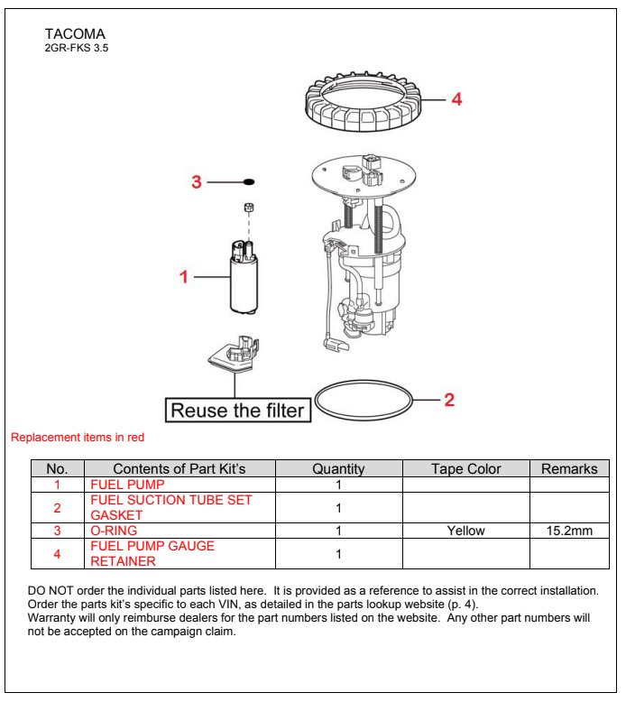

    I used the have the same thing in my 3rd gen 4Runner (It was almost 4 gallons) and was always told that those extra few gallons help keep the pump submerged in gas and cool

    The pump is in a cup with fuel, but more importantly, most all common EFI pumps are a flow through design. Fuel is picked up on the bottom and pumped out the top. Zero heating issues.

    It is also there to protect the fuel pump from overheating.

    Winter you need washer fluid to clear your windshield. Probably why.....you run out it can ruin your day when you cant clear the salt off your windshield. We dont have TPMS required tho.....so my 19 SR5 doesn't have sensors for that.

    LOL! OK, that was the one button I didn't hit... Might be, I'll see if it works next time.. :thumbsup::D
