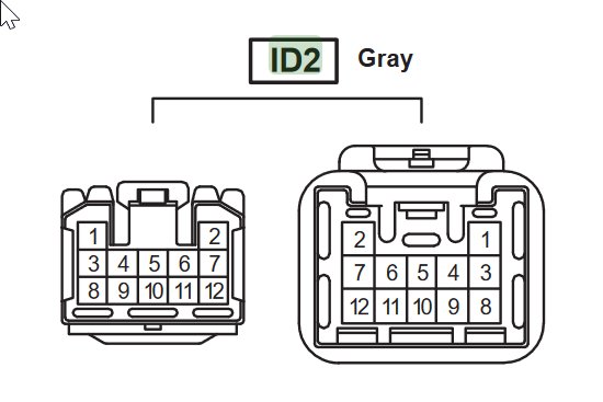

    These are the same thing "fuel sending unit or level sensor assembly".
    The ID2 Connection is in the drivers side kick panel. The float could be stuck. Maybe give the fuel tank a rap or two with a rubber mallet could free it up.
    Pins # 2 and # 5.
