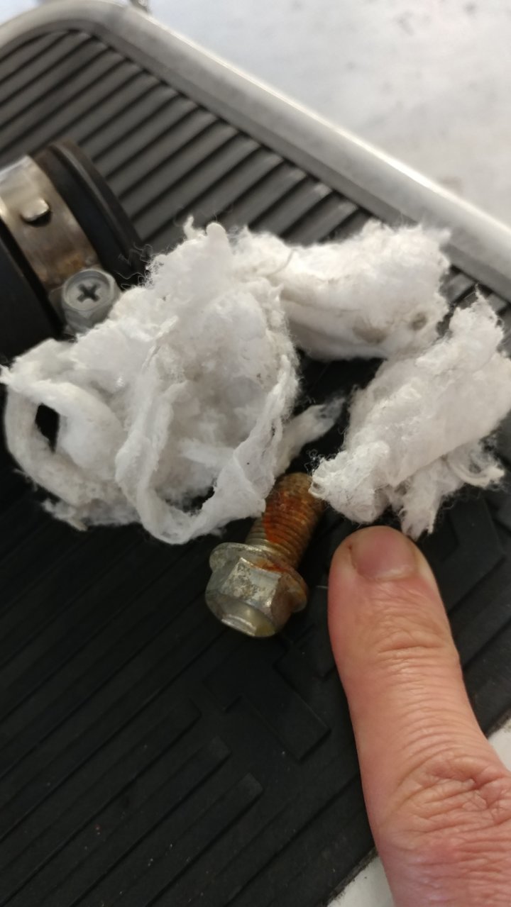

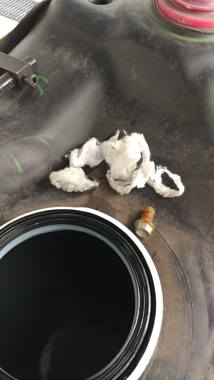

    Okay, so I have my Truck back now. What was found after a lot of diagnostic stuff, new fuel rail/pressure sensor, swapping in another fuel computer etc was debris in the gas tank. This consisted of a fair sized bolt, and stuff like cotton gauze clumps, etc.
    The fuel pump was replaced, as it was felt that stuff was getting tangled in it, and/or it had been struggling enough to pull fuel thru that it could be damaged and lead to an early failure. While part of me wanted that to not be the issue, even though they've had my truck a month now, a big part of me wanted it to be fixed so I could have it back--it looks better in my driveway, than languishing on their lot or service bay. They gave it a robust 25+ mile road test, and it did not stall. It had stalled on them a total of 3 times on their road tests following various diagnostic/interventional measures. As this would be recognized as vandalism rather than a manufacturing defect, I paid for the repair work.
    Have I encountered similar issues before? Sure. Rust flakes from metal tank choking an in-line fuel filter, but after finding low fuel pressure with a simple fuel rail gauge tester, then going to the fuel filter and finding it clogged, no worries. But an '04 Frontier is rigged up differently fuel-wise than a '16 Tacoma, and you can't do simple tests such as this without specialized electronic gadgets. Indeed, it took Toyota with Corporate tech support a month to figure this one out. I'm just glad to have it back.
    The question will remain as to how this got in there, but it's quite likely some scurrilous shitweasel shoved this stuff in. This truck was on another Island for 5900 miles with the first owner, and only on my Island with me for 1400 miles. Someone put this in there on purpose, and hopefully it was put in there by someone who was not a big fan of the previous owner rather than someone who doesn't particularly care for me. Certainly must be the former, as I'm such a nice guy that's never annoyed anyone. Ever......:rolleyes:
    I suppose now, you'll understand why I asked the question yesterday concerning whether or not one can syphon gas from these trucks, meaning--is there some sort of restrictive screen at the bottom of the fill pipe that would prevent something like this being introduced into the tank. At this point, the answer is "I guess not."
    Temperature via my IR/Laser of the HPFP after 8 mile trip home, 149.5 degrees F. I suppose my fingers were fairly well calibrated as this was close to my estimate. At this point, I don't know if this is an issue or not, so we shall see as we accumulate further experience with the new Gen 3 Tacomas together.

    Was the tank completely emptied out first then they fished out the cotton balls and bolt?
    I agree, the bolt looks like it was just shoved in there. Unless it came from a gas pump somehow....

    Glad you got her fixed...but holy shit... someone put that crap in yer tank..??
    I'll have to look at the drawings to se if there is a screen in the fill tube... as I said earlier, I could NOT get a hose in there..!

    Well, the sequence of diagnostic maneuvers and interventions performed are somewhat clouded by me not being there or doing them myself, but at a final point in the series, Tech support recommended removal and replacement of the fuel pump. When they dropped the tank and opened it/removed the pump/sender unit, they noticed the rag/cloth/fiber debris floating around in the gas. They had pulled a gas sample early on in the process, but had not sucked out any fibers on that test, and the gas tested out fine. Then they dumped everything out, and washed out any further debris so the tank was clean.
    I know at the top of the fuel fill spout, there is a flap valve thingy, but the Dealership assures me there are no other impediments to stuff going in the tank, and fuel can be siphoned from these tanks. I am a bit apprehensive about putting on an aftermarket locking cap, as these are not known to seal well, and I suppose I'll end up with a CEL and codes for major evaporative leak, etc. The dealership did tell me that only this week a new Tacoma came back w 146 miles on it, someone had drilled a hole in the tank to steal gas. I suppose I didn't really realize this was a thing. I firmly believe people who do this should be tied to a pole, upside down, after being force-fed industrial strength Ex lax. We could only guess that the bolt's purpose was to provide weight to the rag(s) to help drag it down the fill pipe.

    Well, soon as I find a few suitable hoses, I'm going to dip the wick myself........ May have to sacrifice some of my homebrewing hoses, but they're currently in use on 12 gallons of hard ciders.

    More on the syphoning, @over60 has already responded, but it's mentioned again in other threads.
    If it's so hard to get a small caliber hose in there, how did that big bolt make it down? And all that rag? Hmmmmmmm.
