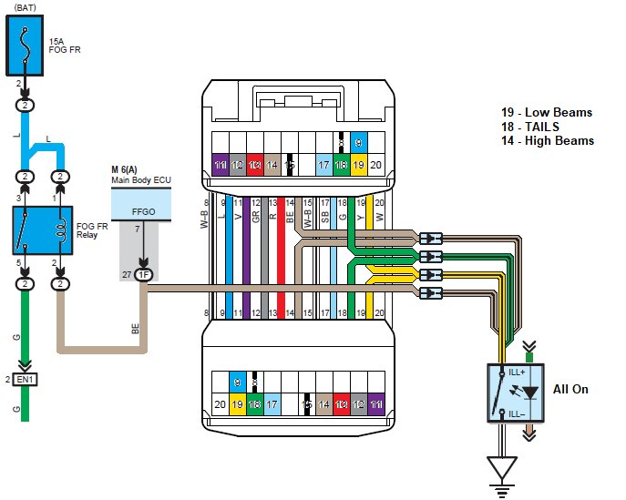

    The lights on the Tacoma are ground actuated, as in the switch on the steering makes ground "sequentially". DRL, TAILS, LOW. High & Flash are in a separate internal setup in the switch. Same for the front fogs.
    If you're wanting for all these lights to be ON at same time, you'll need to tie them and at same time separate them (diodes) so they can work OEM or user modified.
    Front fogs do not turn ON without selecting Parking lights. Not impossible, just more snipping the OEM wires.
    Low Beams do not turn OFF when High Beams are selected.

    Intercept harness to C11_Combination Switch, t-tap the Front Fog beige wire also to by-pass the Main Body ECU control of it. Need to turn OFF- ALL ON switch at vehicle off. All-On switch OFF, all back to OEM functionality.
