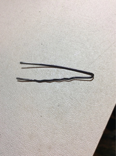

    Yes, remove the jumper once the truck goes into temp check mode then proceed to checking the fluid. It will stay in temp check mode until you turn the ignition off. Removing the jumper wire allows the ECM to stabilize the idle to properly read the level.
    Btw, I made a jumper using a hair pin by removing the coating a bending it to fit. It's about the same size as the pins that are on an obd2 reader.ImageUploadedByTapatalk1450475804.083749.jpg
