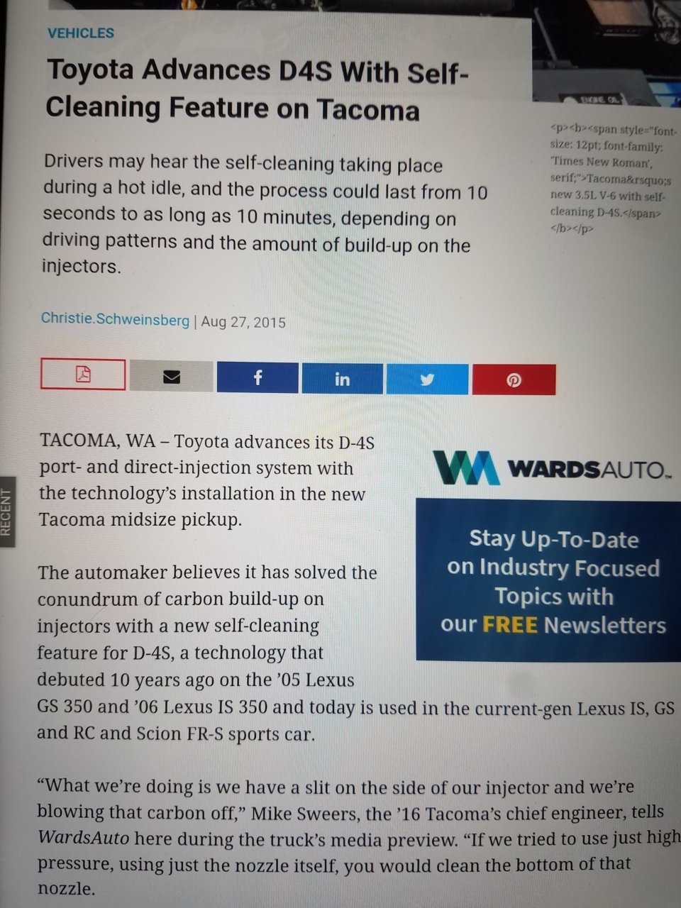

    So yesterday while driving to work it started giving me a rough low idle when I stopped at a light, first time. On my way home same thing then threw a code. Took it to the dealer at 8am and they called aroun 1:30 and needed me to approve 2more hours of diagnostics. Just called me at 3pm and said "everything points to carbon buildup" And wanted to charge me about $900 for plugs and I assume top engine clean as well. (over 1100 with diagnostic fee added)
    I've had a lot of cars and only at like 200k does the carbon buildup really get noticeable but none have acted like this and add to that this truck gets only the best gas and I even add 1k and 3k chevron additives.
    I didn't think to ask what code it threw while on the phone so we'll see if it's on the report.
    I mean I could see bad plugs causing a rough idle for sure and the plugs do have 56k on them...but it literally happened all in one day and it hasn't lost power or fuel economy and I don't normally replace plugs before 60k and have never had an issue, hell I've gone 90k before (iridium NGK's are what I normally use). Hoping it is just the plugs and the "carbon buildup" was so the tech didn't feel like an idiot for wasting all day chasing a maintenance related issue. I'll try to get the code and take a pic of the plugs when I replace them later today. I'll have a peek down the throttle body as well.

    For an engine with a cleaning cycle it sounds fishy too me.

    Weird, I thought the Tacoma engine had direct and port injection? Even so, there should not be significant carbon buildup after 3 years.
    The only way they could diagnose this is with a borescope, so there should be pictures of the buildup.
    I agree, this is not normal and even if it is carbon build up, there’s a bigger issue.

    I agree, carbon buildup to that extreme is unlikely due to this truck being only 4 years old and 56k. And I forgot that toyota markets the direct injection as being self cleaning so that adds to me already questioning carbon buildup as a cause. Plus I only fill up at phillips, chevron, or shell nowdays...all top tier and I have been adding chevron additives on top but not religiously...I shouldn't need to though, that should be overkill.
