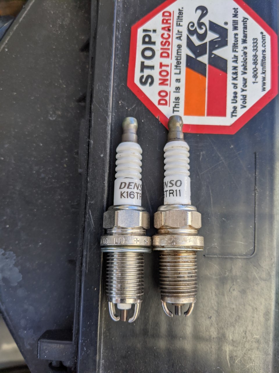

    I am wondering if it is a chinese knockoff. It has less than 500 miles and looks a little different from the replacement I bought, the differences are very subtle. It showed as a misfire in the cylinder. Since I put new Denso and NGK plugs and wires I figured it was the injector. The one on the right is the faulty plug.

    One on the Left looks like it has a longer center electrode.

    You probably have a fake one there between the two,
    There are fake DENSO all over eBay and Amazon,
    You have to get these from DENSO to be 100 percent sure anymore
