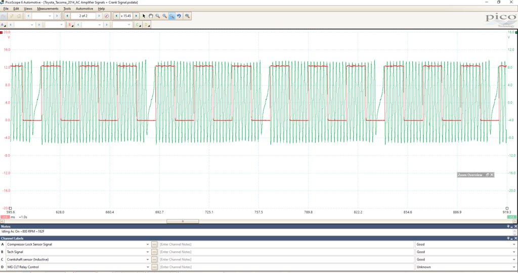

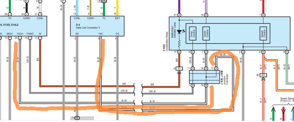

    Is there somewhere I can grab a signal for RPM? Does this truck pass that value somewhere even crudely as say a voltage range or something? I am strongly considering building an aux ECU to handle some odd details like "door lock on (D)rive" and other functions, so it would be really convenient if there was an elementary output somewhere I could feed in RPM as well.

    There is a dedicated Tach line accessible at Pin 9 (Black/White) of the DLC, it's a 0-12v square wave 3 pulses per revolution of the crank.
