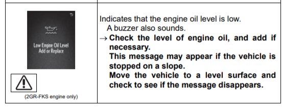

  10. Jan 28, 2020 at 9:29 AM
    #50
    Tripod1404
    Tripod1404 Annihilator tripod
    Dec 13, 2019
    #313228
    424
    As a side note, this is what the low oil warning looks like;
