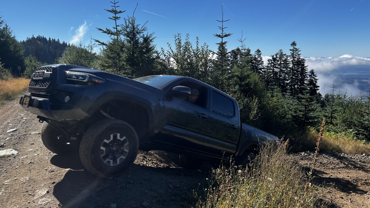

    While I was 4 wheeling last week I had the low oil light come on several times.
    It was while on an incline or decline for an extended amount of time and would turn off once we leveled off- has anyone else experienced this and is there a remedy for this?
    photo included for an image of the approximate angle that I’m talking about.

    I’m really estimating bc I had my eyes on the road - it WAS steep, narrow, and loose - the low engine oil caught my eye (obvs) with a little warning beep that accompanied it. I could have been 30°+ but it didn’t seem excessive compared to where I’ve been with other rigs, including a Toyota (last gen pickup).

    My wife took this pic - and this photo was merely included to give an idea of the angle that the truck may have been in when the warning came on. It didn’t actually happen here.
    Fortunately no smoke - but the warning came on at two different times and very briefly each time.

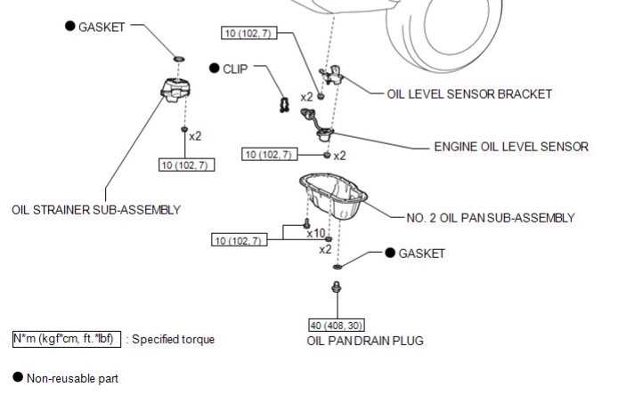

    There's an oil level sensor in the oil pan so no doubt it 'sees' low oil at certain angles. This is a car engine after all.
