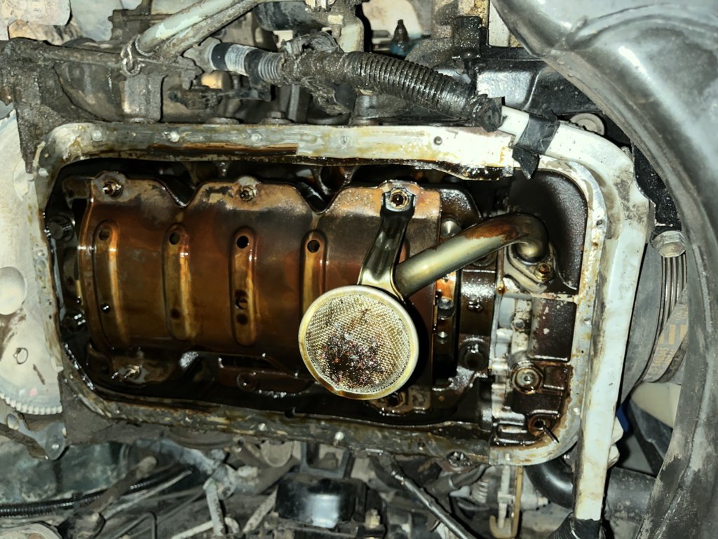

    While getting the oil pan out I was forced to drop the transmission. Great time to replace the warn cv axles. When putting the transmission back into place after putting the oil pan back the transmission dropped on my head and caused some mild trauma. Definitely hoping to avoid ever taking the transmission down again. In the photo below you can see some dirt and debris on the oil pick up tube which nothing was magnetic or metal. I cleaned it off completely but still having the issue.

    An inspection of the pickup assembly would have been in order too. Welds crack, gaskets get hard and crack. Any place where it can suck air it will suck air. In my high mileage Nissan D21's, 300k+ I would run straight 50w and let it warm up before I would put any sort of rpm into the motor. Those old hardbodys with the twin plug 4 cyl motor, IMHO motor wise, are just a smidge better than a Tacoma.
