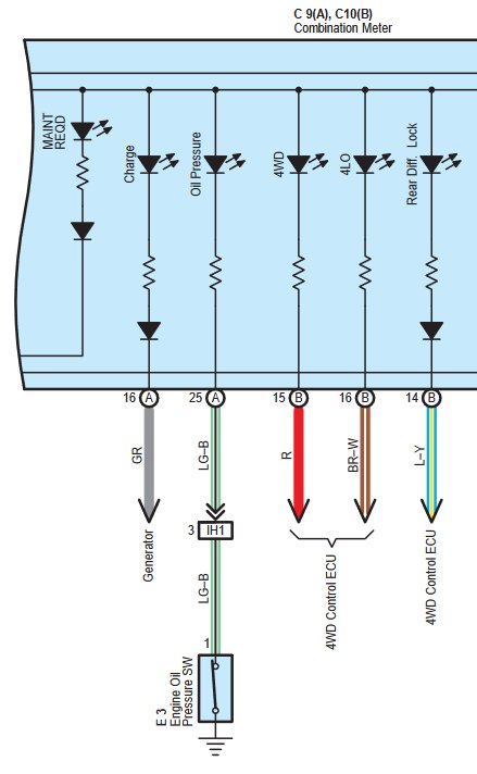

    Jimmyh
    Jimmyh Well-Known Member
    May 16, 2012
    #78991
    14,279
    SC
    2012 Prerunner SR5
    " Said that the oil pressure key that slides in on start up dosent immediately go on which brings out the knock noise on start up. "
    None of that makes any sense.
    What is an Oil Pressure Key?
    Slides into what?
    What you do have is an Oil Pressure Switch that opens when the oil pressure is above the set point. If it drops below the set point it grounds the negative side of the Oil Pressure LED and turns it on. That is the extent of the oil pressure warning system period.
    See below:
    TnShooter likes this.
