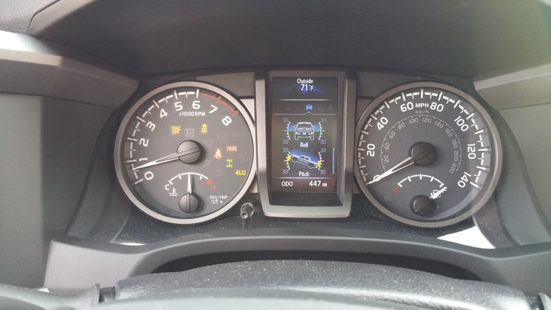

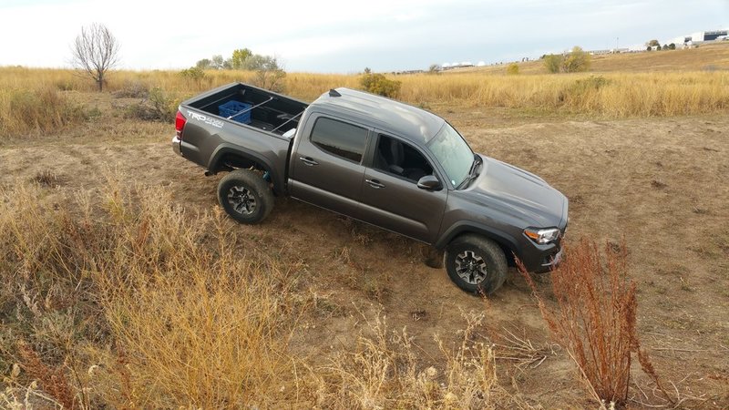

    Well after reading this thread I headed out to some hills right by my house with my daughters. I was hitting 25 degree pitch and 10 degree roll. Jumped out to take a pic returned and sure as shit my master light was on with low oil pressure. I kinda freaked out and rolled down the hill and it shut off. Wish I would have took a picture of the display. Anyways I hit some other 25+ hills and let it sit. Nothing. When back to the same spot, parked it and nothing. I could not get it to come up again. Went home for an hour and went back. Same hills with no avail. Makes no sense that I could not replicate. After work tomorrow I will try again and see if I can catch it with a video....here are the hills, looks like Toyota has a big problem on their hands...

    It's weird because I went to the same angles rev'ed, let it sit and it did not return. I could not duplicate. Tomorrow I will do a straight up, straight up right/left, straight down and down right/left. It kicked on facing down with nose pointing left. The pic facing down was when it was on.....

    Hmmmm we may be on to something here!! I was nose down, and on a decline Around 18% like I mentioned in my thread. Hopefully we can narrow this down
