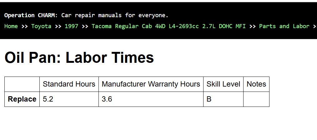

    not too bad labor time
    i had to replace T cover gaskets on my 2.4L
    book time was 9.8hrs (have to take off oil pan to get to T cover off)
    took me 4 days but ZERO oil leaks now
    just alot of bolts brackets.....make sure you bag and tag!
