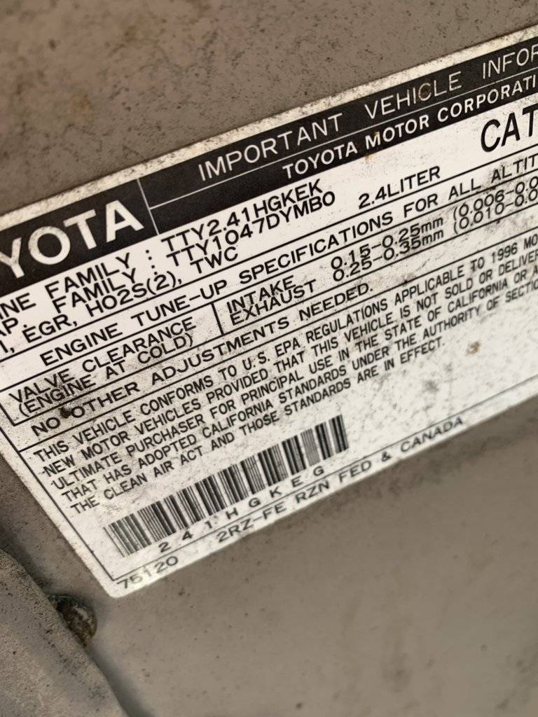

    just bc want your profile to be correct
    2.4L or 2.7L are the tacos 4cyl
    check hood label to confirm
    Mine
