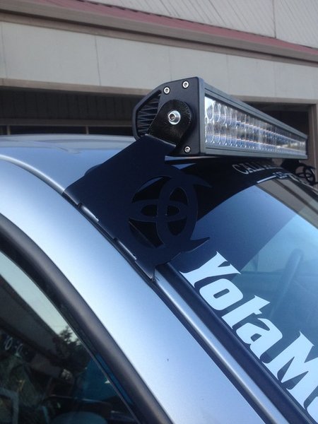

    Have you installed your mounts yet @Sicyota04 ?? I got mine in the mail not long ago, the eazy company with CNC Toyota logo, ready to do my install!
  8. Sep 20, 2015 at 8:22 PM
    Sicyota04
    Sicyota04 [OP] Slowly but surely.
    Jan 9, 2015
    #145940
    3,561
    Morgan
    California
    04 DC 4x4
    Yeah they look great! I used rivets and right after this picture I took the Allen head bolts out and got locking ones. I ran the power cord / wiring harness across the headliner down the A pillar on the inside instead of straight down the A pillar underneath the weatherstripping between the door on the outside down to the fender

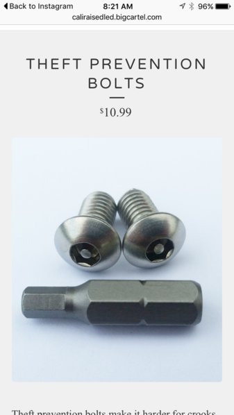

    I just used some Rust oleum gloss since they come powder coated/ primed. I got the locks from @cali_raised_led off of IG for $10.99 for 2 locking bolts and a bit. For the top bars you want to buy the shorter locking bolts. I bought my 20" light bar from @cali_raised_led that I have on my bumper and they just so happened to be having a 20% off Labor Day sale so I got my locks for $8.99 w/ free shipping and no tax
  11. Sep 21, 2015 at 8:21 AM
    Sicyota04
    Jan 9, 2015
    #145940
    3,561
    Morgan
    California
    04 DC 4x4
    These one's right here.
