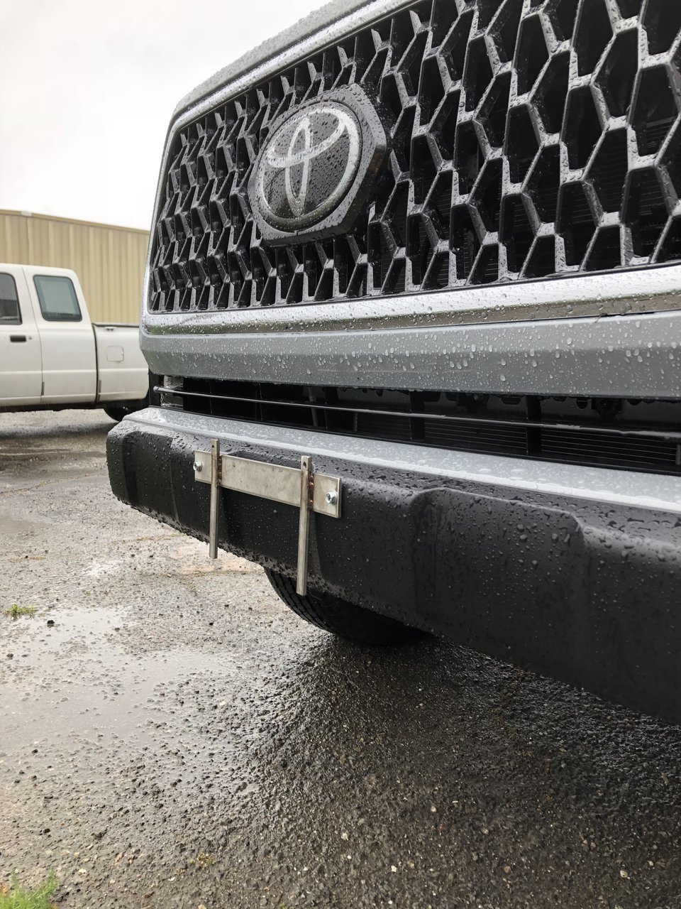

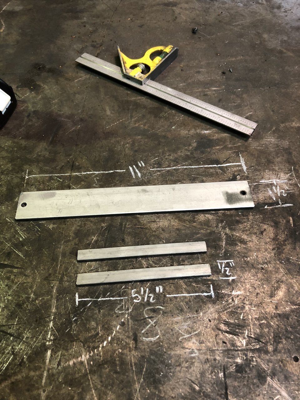

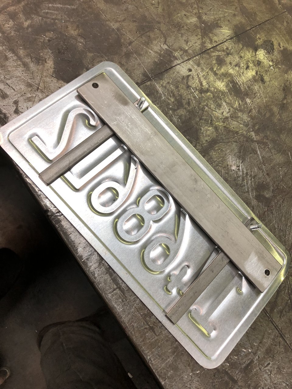

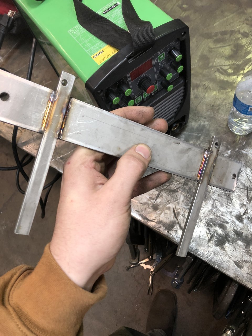

    Was able to fab up a simple license plate mount today so I could get rid of that bulky plastic one. Thought I would share it with y’all in case anyone was interested in making one.
    All that is really needed is 3 pieces of stainless flatbar (size optional to what you want or have available. I found these in the scrap bin)
    main base plate:11” x 1 1/2” x 3/16”
    2 pieces that hold the plate: 5 1/2” x 1/2” x 3/16”
    Once drilled and tapped the 2 pieces, I figured out where I wanted them mounted on the base And sparked those bad boys together.
    And voila you got yourself a nice alternative to that stock turd of license plate mount!

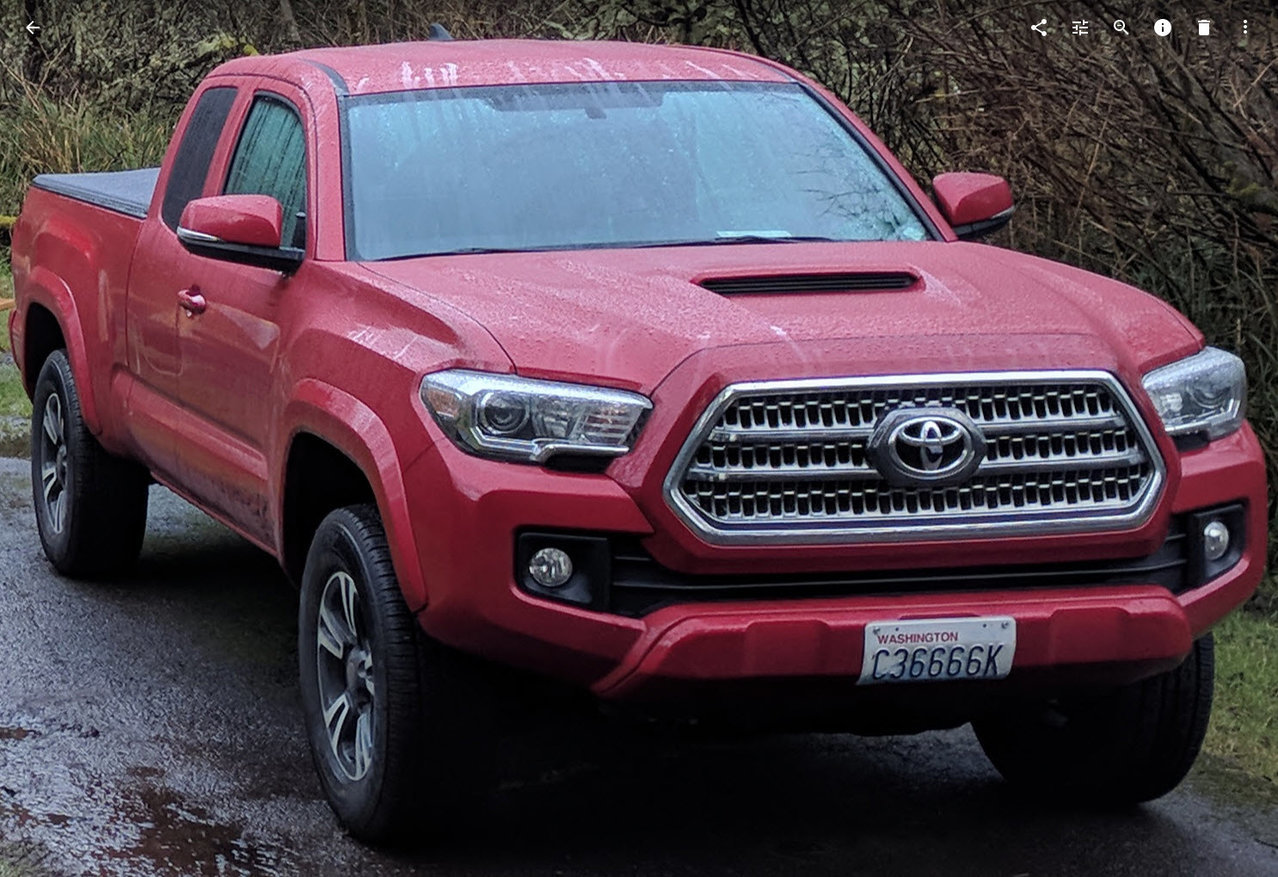

    I went a bit simpler and lower profile. Haha! The OE mount is definite crap.
    I re-drilled the plate to match the holes from the original mount.

    Look like some nice welds on that too...:thumbsup:

    ScubaSteve, curious - why weld on those vertical pieces? Couldn't you just drill out the mounting points on the main bar?

    The plate would be hanging too low in my opinion if it was on the main bar and there is more support with the 2 pieces behind it
