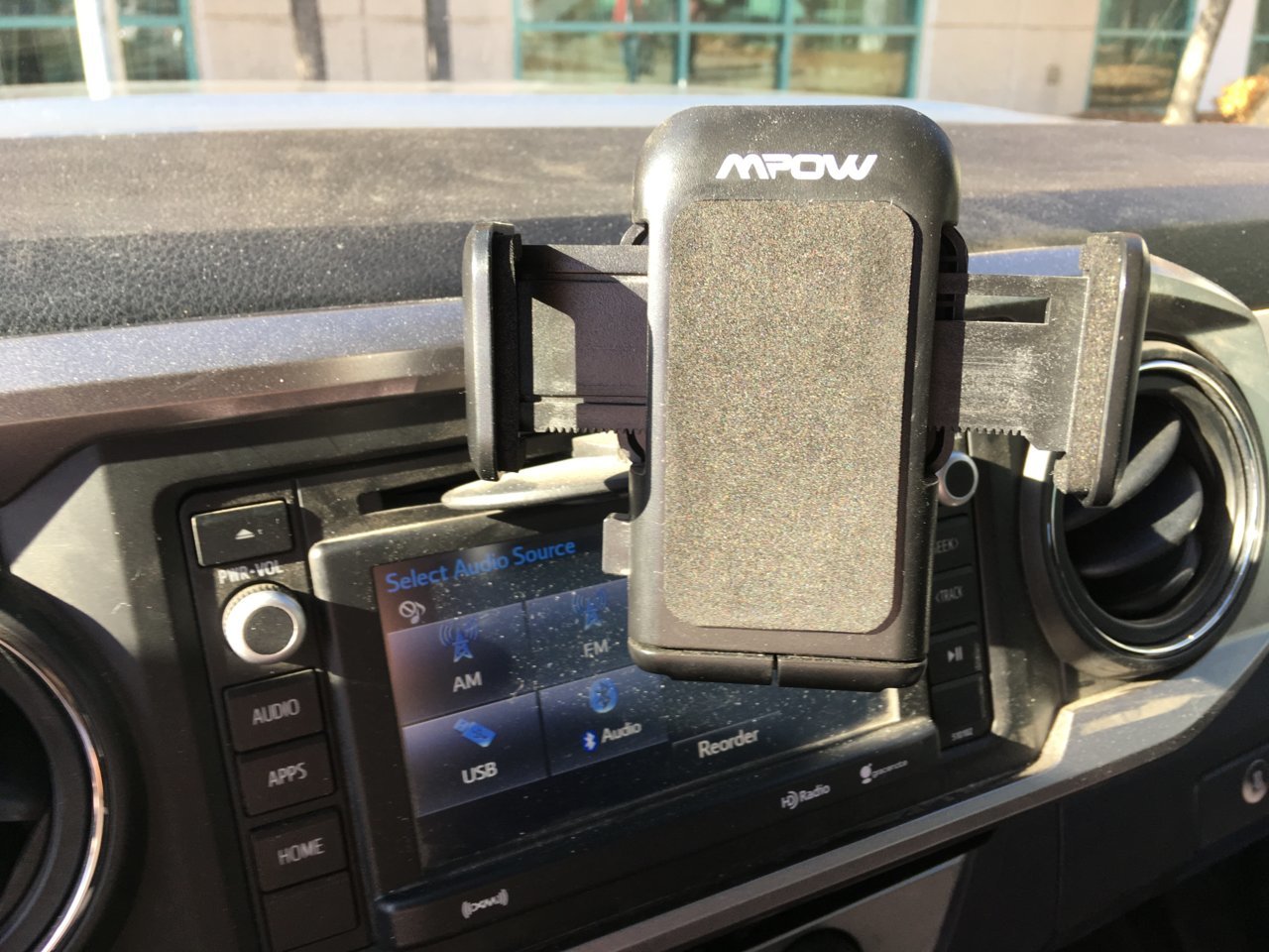

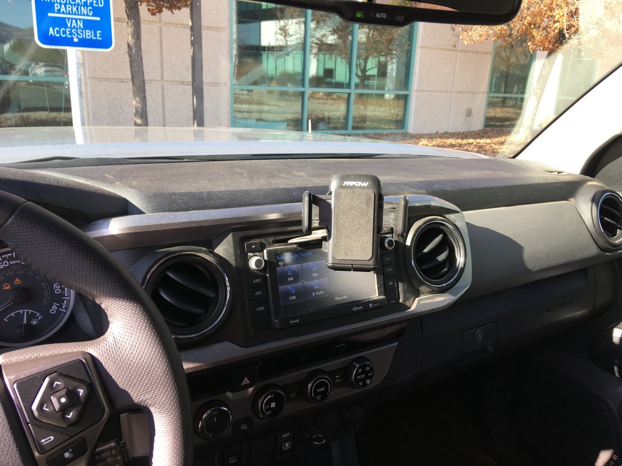

    Hooks onto the top rail trim piece. No drilling which is the best part.

    Then its similar to this one with no adhesive either.

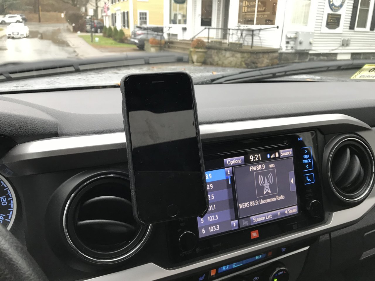

    This is what I have and it’s perfect. Holds well and doesn’t move. I added some 3M tape to make sure, but it was pretty solid before. Completely out of view when the phone isn’t there.

    I have this same set up. It works well for most driving and simple dirt roads. It doesn't so so well when you start doing more technical trails or are on a bumpy forest road for some time. I like to keep the phone in landscape mode also, so it doesn't block the engine display.

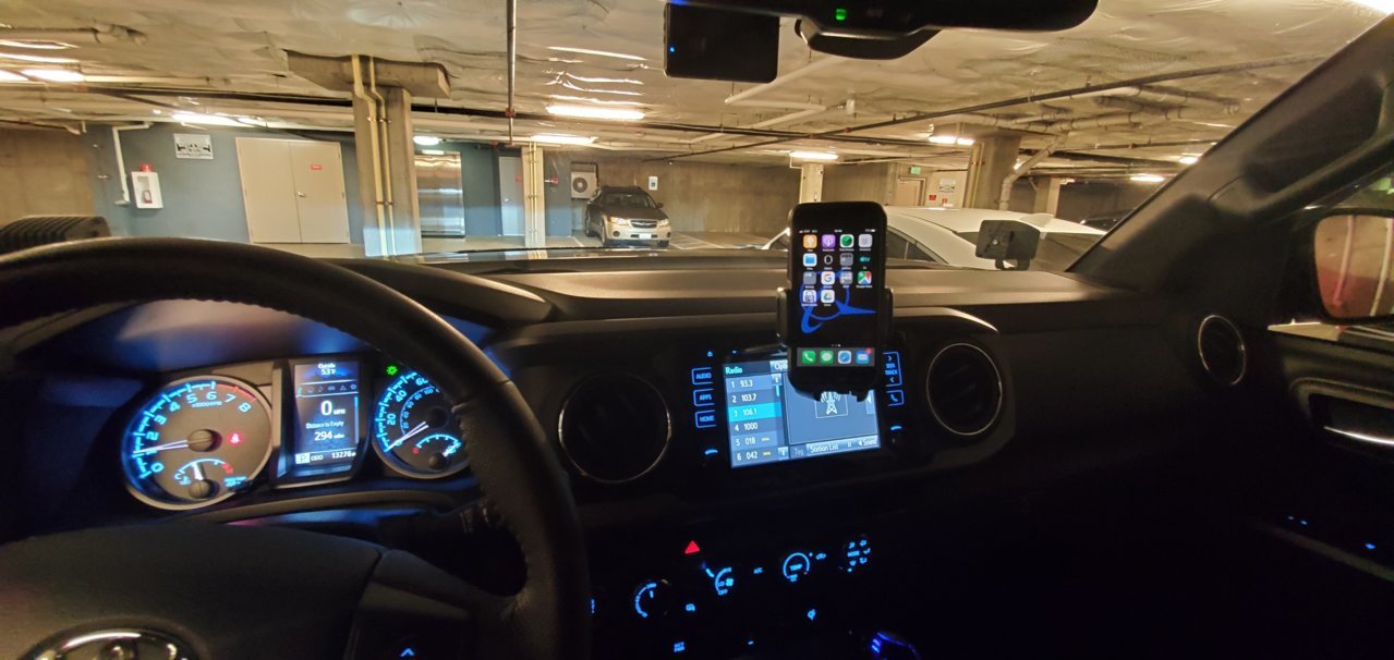

    This is what I use. I don't think anyone uses the CD player anyway.20191119_164011.jpg

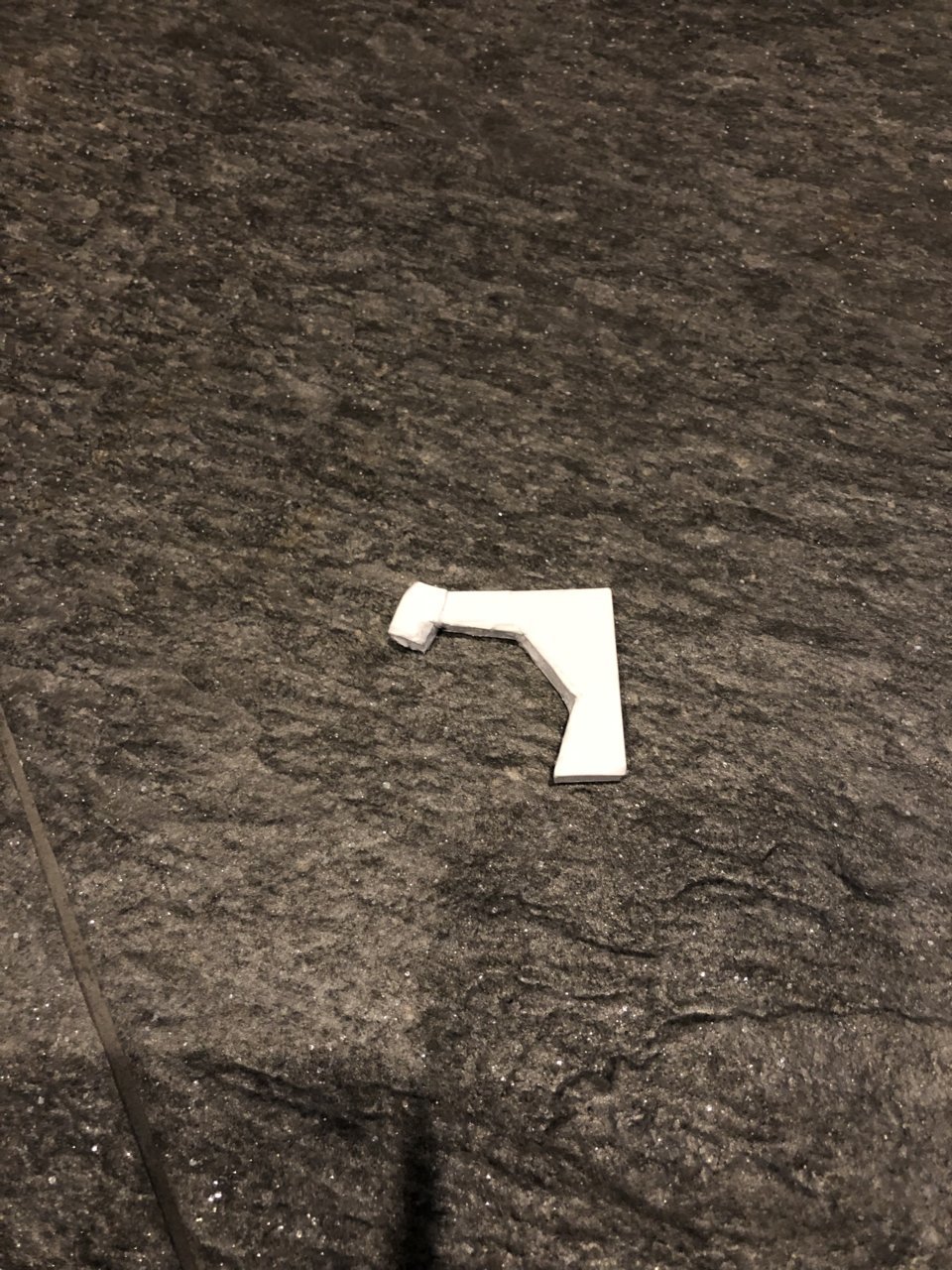

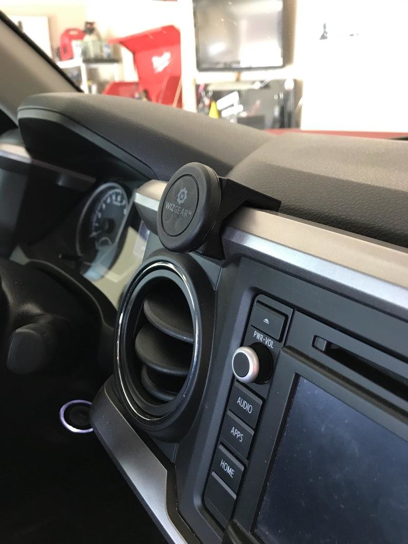

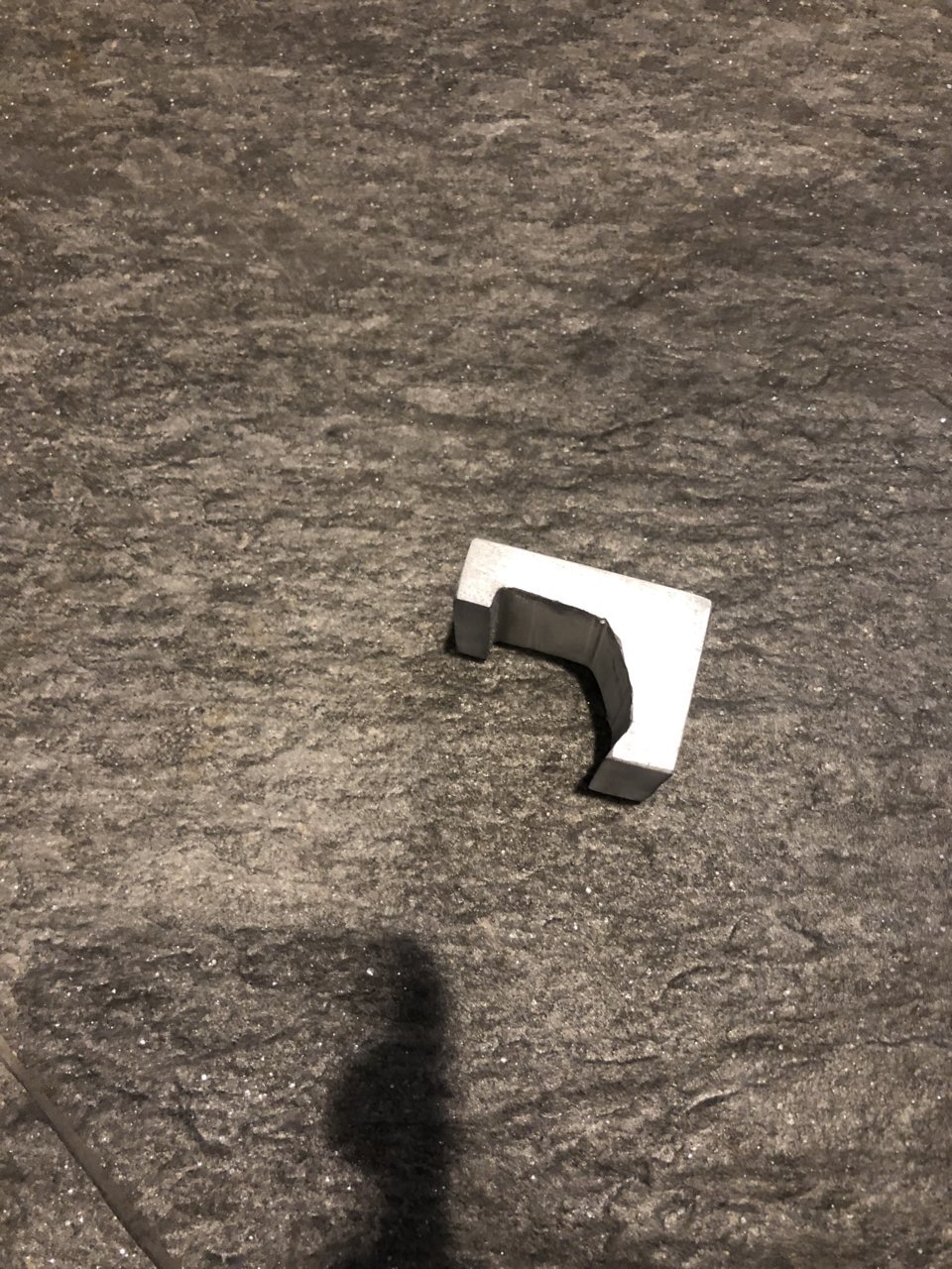

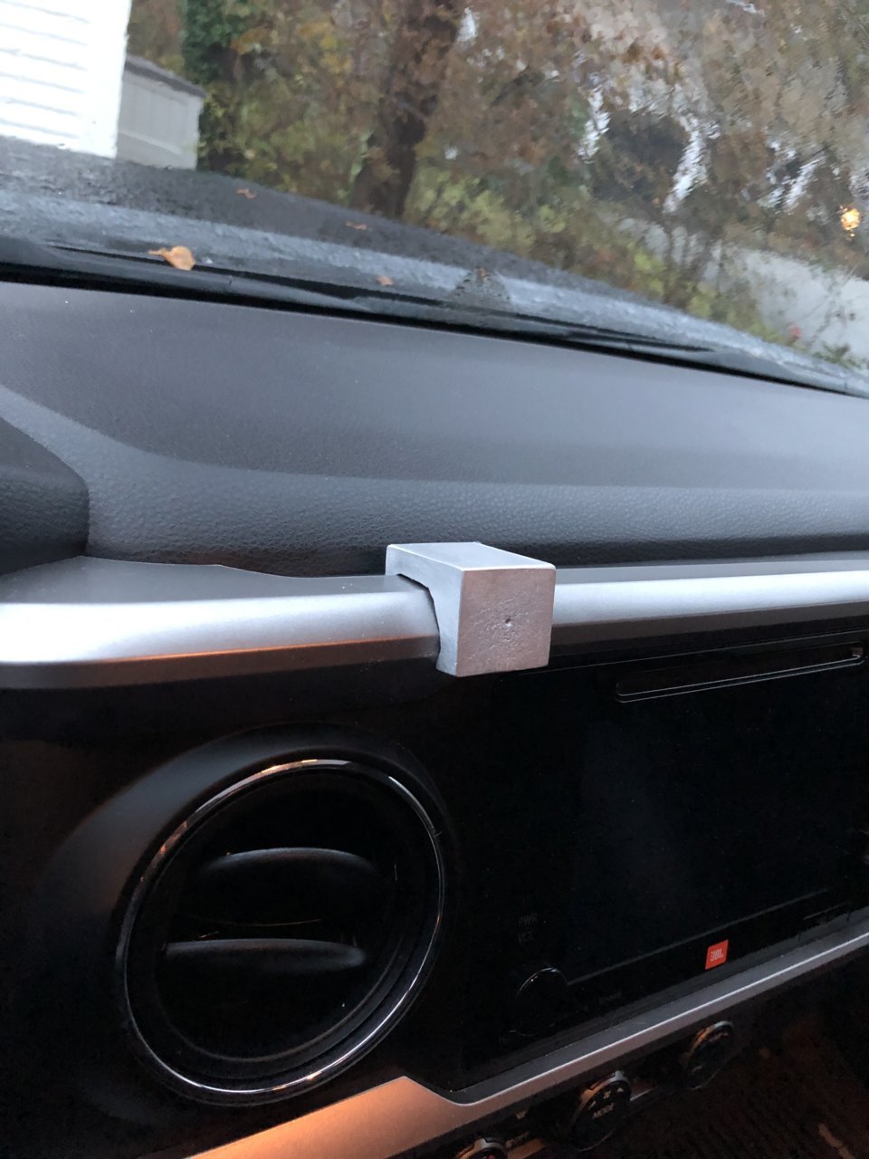

    Well, after looking at many options, I bought the $10 WizGear magnetic mount w/ adhesive back from Amazon. Then I built my own attachment base that clips onto the dash trim. I used playdoh to take a mold and do a cardboard mockup. Then cut profile out of a scrap PVC picket. I spray painted it silver since I didn’t have black. Works surprisingly well. Here are the process photos:
    EFA7DB31-7FFE-4A36-9963-326D37FA93FA.jpg 30761E63-F69F-4EF3-B1EF-6251FB875090.jpg E72A743D-092E-4E5D-892E-07CC78384F84.jpg B8EC33EA-E7D8-4AB1-B00D-827F2B252FEE.jpg 2C7533D0-98A7-41EE-B349-6493DA83492D.jpg

    Some flags and center console divider... lots of things on the wanted list.
    Now patent the clip and start making more of them. Charge $12 for the piece... Buy a few more of the mounts and upcharge them 2$.

    Too much work :) Plus there are a couple of guys selling similar clips (3D printed) on Etsy. One product only had a left-right motion and the other supposedly had a weak magnet (according to reviews). The third guy no longer makes them. So I built my own - it took me an hour or so and we'll see how long it lasts.
