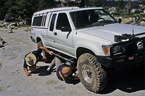

    This is whole lot less sketchy than how it was shown earlier in the thread.

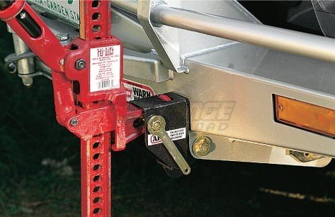

    My old ARB was the original style, which was more slim. Part of the reason for that was air bags and crumple zones. My old truck didn't have any of that, so the ARB was just a steel bumper bolted on. Now they have a sub frame you put on first that is supposed to help mimic the profile of the stock bumper so the air bags deploy in the same way. I dunno, I don't see how but OK.
    Anyway, that old bumper had a Hi-Lift adapter you used instead of including the slots like they do now. Very positive interface between the jack and truck. You had to watch that the base of the jack didn't slip but there was no worry about the bumper falling off the jack.

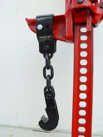

    Instead of a shackle like was shown, I'd probably do something like these personally. I just don't trust anything on top of the lifting arm, I like having a bolt or threading the shackle pin through the hole to make sure nothing can move.

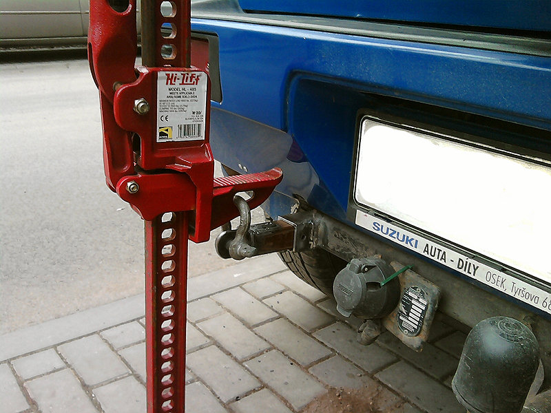

    Not sure about this last picture. I would spin the shackle the other way and use a larger one. I think a 1/2" shackle is the largest that will fit through that way and they are usually rated 2 tons WLL. The pin on a 5/8" shackle will fit through that slot. A 3/4" shackle is rated 3.25 tons WLL, which is higher than the Hi-Lift (which is 4,660 lbs). The shear pin on a Hi-Lift is designed to give at 7,000 lbs.

    That last pic is sketchy. That hole is meant to keep things from moving and slipping, not intended for the load limit of the jack. That skinny piece of metal is definitley the weak spot in that setup and would fail before the shear pin would...

    Hadn't thought of that, excellent point.
    BTW, the sketchy part I had in mind was slipping. Hi-Lifts aren't stable as it is and hanging a shackle like that didn't seem like it would be very positive engagement.
    I was thinking based on this:
    Now that I think about it the winching kit that I have uses a band that wraps around the lifting shelf:
