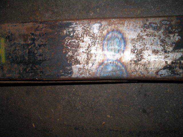

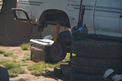

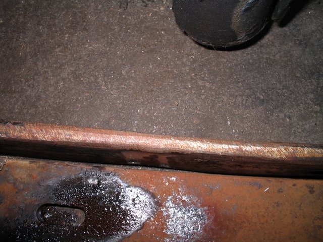

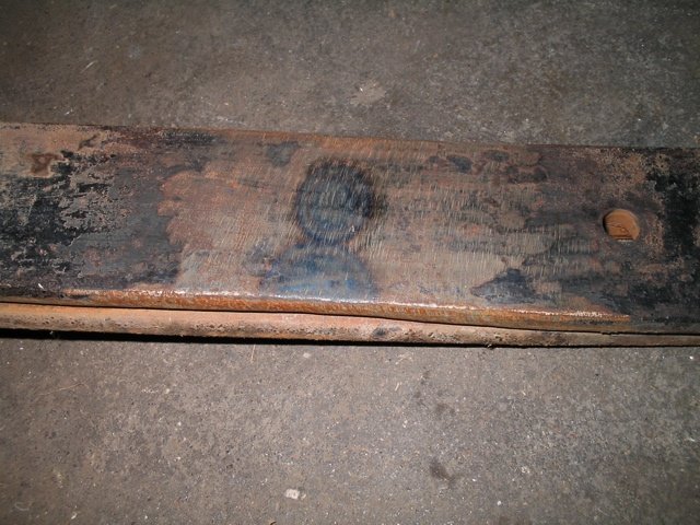

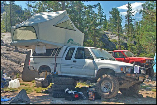

    I once broke a leaf spring and the Hi-Lift was the only way to lift the truck off the suspension to repair it. That was in Rubicon Springs during the TLCA Rubithon in 2008. I was lucky Marlin and James were there and James was able to weld the spring back together and I got out driving on my own.
    Since the spring was broken I had to figure out a different way to get the truck raised and onto the jack stand of tires. Hi-Lift under the slider. In this case I could have used the bumper but my jack is only 48" tall and I couldn't get the truck high enough to completely lower the axle, so had to move it in front of the axle and used the slider which was lower and didn't need as much of an angle. The bottle jack worked great to lower the axle slowly, though.
    BTW, I agree, I prefer to use a bottle jack whenever possible. But the Hi-Lift works for several things so I don't also need a come-along, between the front winch and Hi-Lift I can solve most problems. I do carry an extra 25' extension of winch rope, that is very handy, too.
    Here's some extra shots of the work by a very talented welder. Lots of passes, lots of grinding, lots more passes. This was with a Ready Welder in the field.

    Nice! See that looks like a well thought out use of everything for a field repair. Tires chocked, a "jack stand" of sorts, level ground and so forth. And most importantly you had others around to assist you. Perfectly good use of a high lift in my opinion even if I'm not a fan of them in general.
    I'm not a high lift hater overall. I just try to emphasize they are quite dangerous tools and easy to misuse. Particularly in the case of solo travel you need to be extra careful in considering if your particular situation warrants the risk of using one. Usually there is a safer way to solve the problem with other tools.
    Personally after carrying a high lift for about 15 years and finding I never had to use it because I could use other tools more safely I've stopped carrying it. Others of course can make their own decisions, but I'd strongly advocate always sitting down for a few minutes before doing anything with a high lift and thinking if there is a way to use another tool to get the same job done more safely. If the answer is no spend a few more minutes thinking if the particular situation you are going to use the high lift for is worth the risk to health and safety versus getting help for your recovery. And remember accidents that result in just injuries when there are people with you can easily convert into a fatality when you are solo.

    Ha ha. I bet, that was a really impressive field recovery. Welding job is amazing. Awesome rig in the photos, do you still have it? Used to have a 1992 but sold when I got the Tacoma.

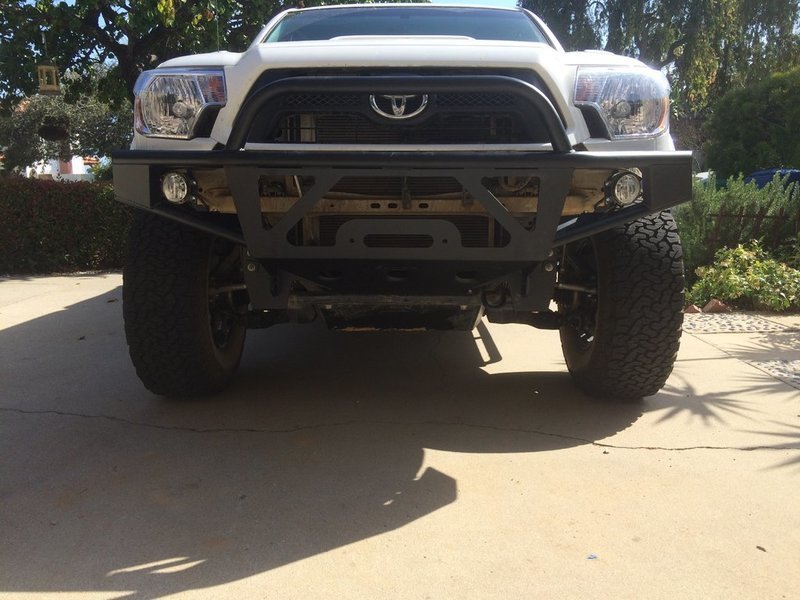

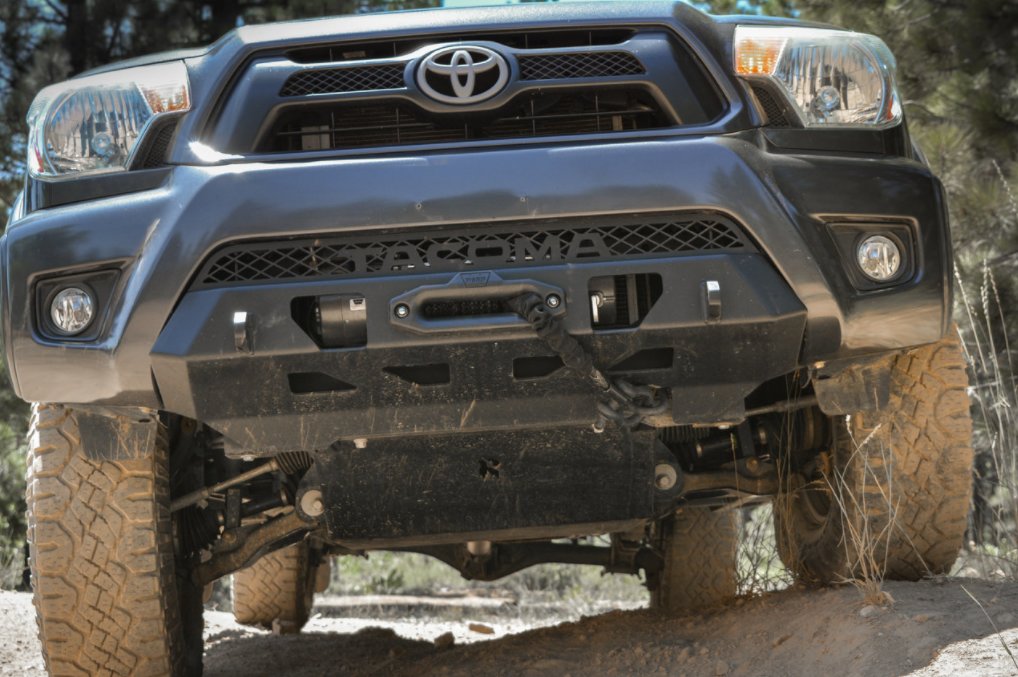

    My CBI Dakar has jack points - under the top hoop, or on either side where the fog lights were:
    Even after adding custom hoops, you can still jack from under the top hoop:
