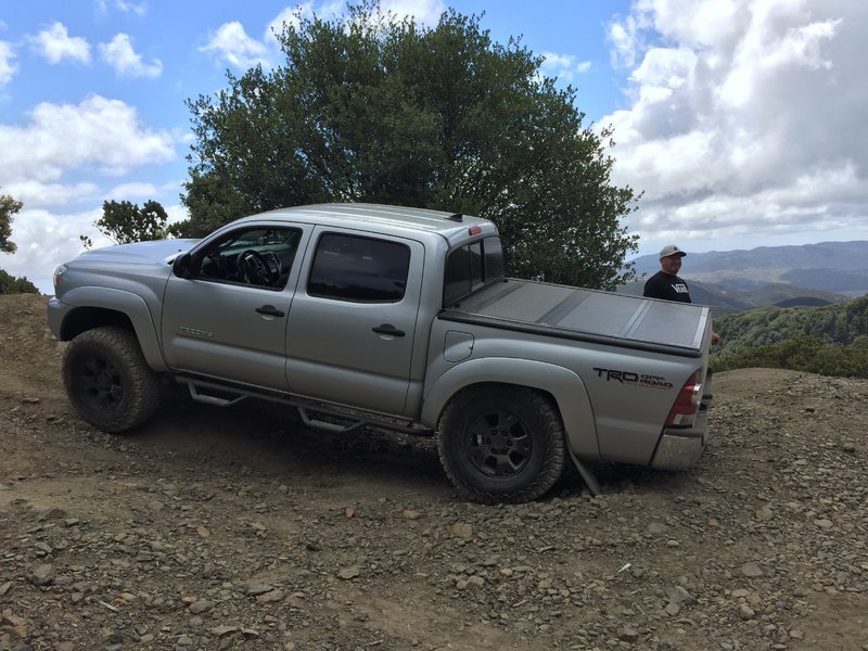

    I should prob get a set. Will it help avoid this type of tucking in the rear fender well? I popped a couple rivets this weekend and would like to avoid doing any more damage.

    It won't help that if it bumps at the same position as your stock bumps. Full bump would be at the same place just like your picture.
    You need to either limit your uptravel or trim your fenders. I wouldn't limit up travel unless you were bottoming out your shocks. I wanted to know if these bump stops were height tunable for the people that are running longer than stock shocks.
