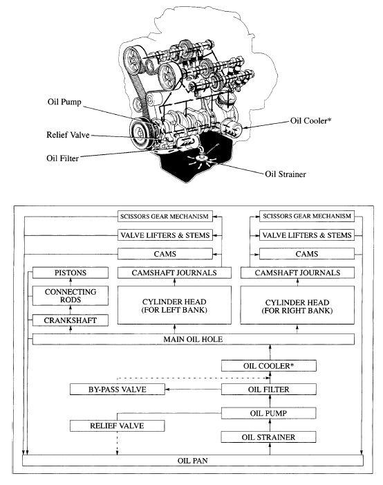

    By all means check that out but a restriction in your remote filter system should increase the pressure seen by the pressure switch while starving the vital engine parts. That's one of the reasons I decided against a remote.
    This is based on this diagram (Toyota document) and my assumption that the switch is between the pump and the filter.

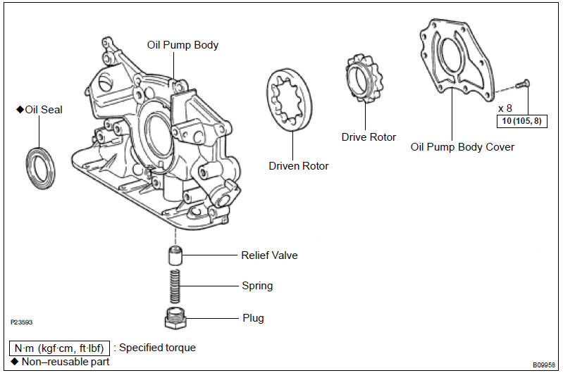

    Still no luck. Im guessing the oil reliefe valve is stuck open. Anyone know where this is on the 5VZ and how to replace it?

    What is your exact idle RPM and oil pressure. Until you have this info you are just guessing.
    The general location of the PRV can be seen in the diagram in post 28.
    To access it merely drop your skids, front diff and oil pan. It's right there. Pretty big guess.
