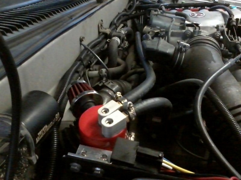

    You reset your idle with it all hooked up and vaccum leaking there at the PCV?.

    I didnt reset idle, no. The ECU might need to self adjust :notsure: Im going to pull the TB out and clean it and the IAC next weekend. Idle should be fine then. Engine still runs very smooth though.

    Its not the can, its the PCV valve. Had a very rough idle for as long as I can remember but I never noticed until I installed my can. I initially ran it with a vent and just capped the intake manifold but the blow by gasses were getting into my vents.
    I decided to clean up the PCV valve and hook the can back up to the intake. Didnt have the horrible idle so I figured the valve wasn't leaking anymore. I guess it still was :notsure:
    Don't know why it was causing the oil light to come on, just happy its off :thumbsup:

    Not exactly. The blow by would give it a positive pressure thus needing the PCV (positive crank vent) valve to release. Crank pressure should be slightly higher than atmospherics I would think. I don't know much more beyond this except to say when the catch can is hooked up, oil light comes on at idle.
    So Im assuming somehow the crank pressure is lowered or even negative. Since the oil pan shares the same atmospherics as the crank, maybe the negative pressure is creating a suction action on the oil and working against the oil pump? I may be over thinking this...
    Idle was/is smooth and not very jumpy. Tach needle didnt move at all :notsure:

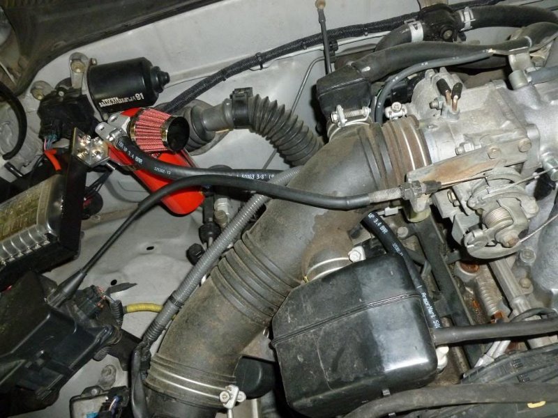

    "maineah" is absolutely correct.
    The system is wide open to filtered atmospheric pressure air. This "open" point is the hose running from the rear of the intake tube just ahead of the t-body to the rear of the driver side valve cover. The PCV valve works on manifold vacuum not pressure. It allows a small controlled amount of manifold vacuum to draw blow by gasses out of the engine at the pass side valve cover while fresh filtered air is allowed to enter at the driver side valve cover. Hence the crankcase is ventilated.
    Finding oil in that inlet hose ahead of the t-body is a dead giveaway of a malfunctioning PCV valve or a worn engine producing more blow by volume than the valve can handle.
    That's not retarded, below is retarded.:rolleyes: Both of these set ups are doing absolutely nothing other than taking up space and causing problems. Sort of funny no one picked up on this in the guys build thread.
