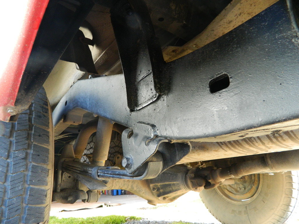

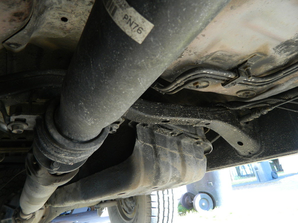

    This is really not a Gen 1 question but there is not a general discussion for rust issues.
    There are countless threads on rust but after reading them for 3 days I feel none were a good fit.
    This thread is a great list of links to products and issues.
    https://www.tacomaworld.com/threads/rust-prevention-treatment-consolidation-thread.355928/
    Years ago, when living in Wisconsin (LOTS OF SALT), I had a "toyota pickup" and a "t100" that looked like sunken battleships. I recently acquired an 04 taco with low miles and almost no rust, by colorado standards. It took over 5 years to find one. The attached photos are really the BAD spots. The BODY pannels are perfect, frame and components... not so much. It has been garaged it's whole life and will not have that luxury now because my garage is full of projects. I plan to use fluidfilm on it because it seems to be the fav of many on this forum. If anyone wants to direct me in a different direction i am all ears.
    The big question is do i wire brush off the rust before spraying fuidfilm? it is really superficial and I feel like it would only destroy what little manufacture coating is on there.
    This truck has no grease and feels like it had no silicone like treatments that would reduce ability to paint. Should I paint? I fear any paint like substances would just lead to pustules of ferric nastiness. But I will never be able to paint AFTER fluid film is used, right?
    It is really arid here in CO, things dry fast. I fear painting over rust would increase moisture more than it would decrease oxygen availability. Maybe i am way off.

    There doesn't appear to be any factory coating on there that I can see. I would wire brush the rust spots to get any loose stuff off.
    No need to get crazy on the wire brushing. Then spray just the rust areas with Rust-Oleum Rust Reformer. After that Buy a Quart of Rust-O
    leum Paint and mix it with 3 or 4 parts Mineral Spirits. That will make a very watery mix that will seep into every crack and joint. Throw
    that mixture in to a garden sprayer that has a long flexible wand. I just sprayed everything under the truck and stuck the wand into the
    frame and sprayed that. Have a brush handy to catch drips. There will be a lot of them. Have a lot cardboard or paper under truck to catch excess paint or just do it outside on gravel.
    I like this method, easy to touch up any spots you missed the following year. The best part is its pretty cheap to do. Its worked real well on my truck.

    Thanks for the suggestions Sin and Seedytech7. I am rethinking my plans to match your advice. And I renamed the title to solicit more.
    I am leaning towards this idea because it sounds fast enough for a late fall day, garden sprayers would be better in holes, and I think i am just going to miss the important parts if i brush on Chassis Saver. I have local sources for of rust reformer and the non spray bottles of rust reformer. It is water based per the tech sheet. So if i want to do the garden sprayer trick should i still use mineral spirits?

    I just doubt i can paint Chassis Saver or anything with the short days and cold night. I doubt i could tape off the moving parts, wires cables, etc.
    Does Fluidfilm make paint not stick if i fluid film now and paint in May?
    Finally warm enough to wash it. I removed the original photos and put up better ones above.

    Wire brush and Rattle can will be a waste of time. Spray can paint goes on way to thin to protect anything. It will be just as rusty next spring. You need to spray with rust converter then cover it up with something heavier.
    There's nothing under your vehicle that you can't paint. Just spray everything that's rusty. If your going to use a garden sprayer a few good places to spray besides inside the frame are... Top of the fuel tank, you cant see what your doing when you spray but salt and moisture will sit up there and rust out the tank. Behind the cab at the bottom there is a plastic plug, pull those out and stick wand in there and give it a squirt. Open up the door and shoot it into the fender. These trucks like to rust right at the top of the wheel well. You can also do the same with the rear fender. Be ready to clean up any paint that comes squirting out!
    Whatever you end up doing will help a lot. Your truck looks to be in good shape just like mine was when I got it. Just a lot of surface rust.
    Its not a paint and forget thing, You'll want to crawl under there and every year and touch up any areas you find.
    A good investment is a power sprayer. You don't want any mud or dirt full of salt and moisture to sit anywhere on you vehicle.
