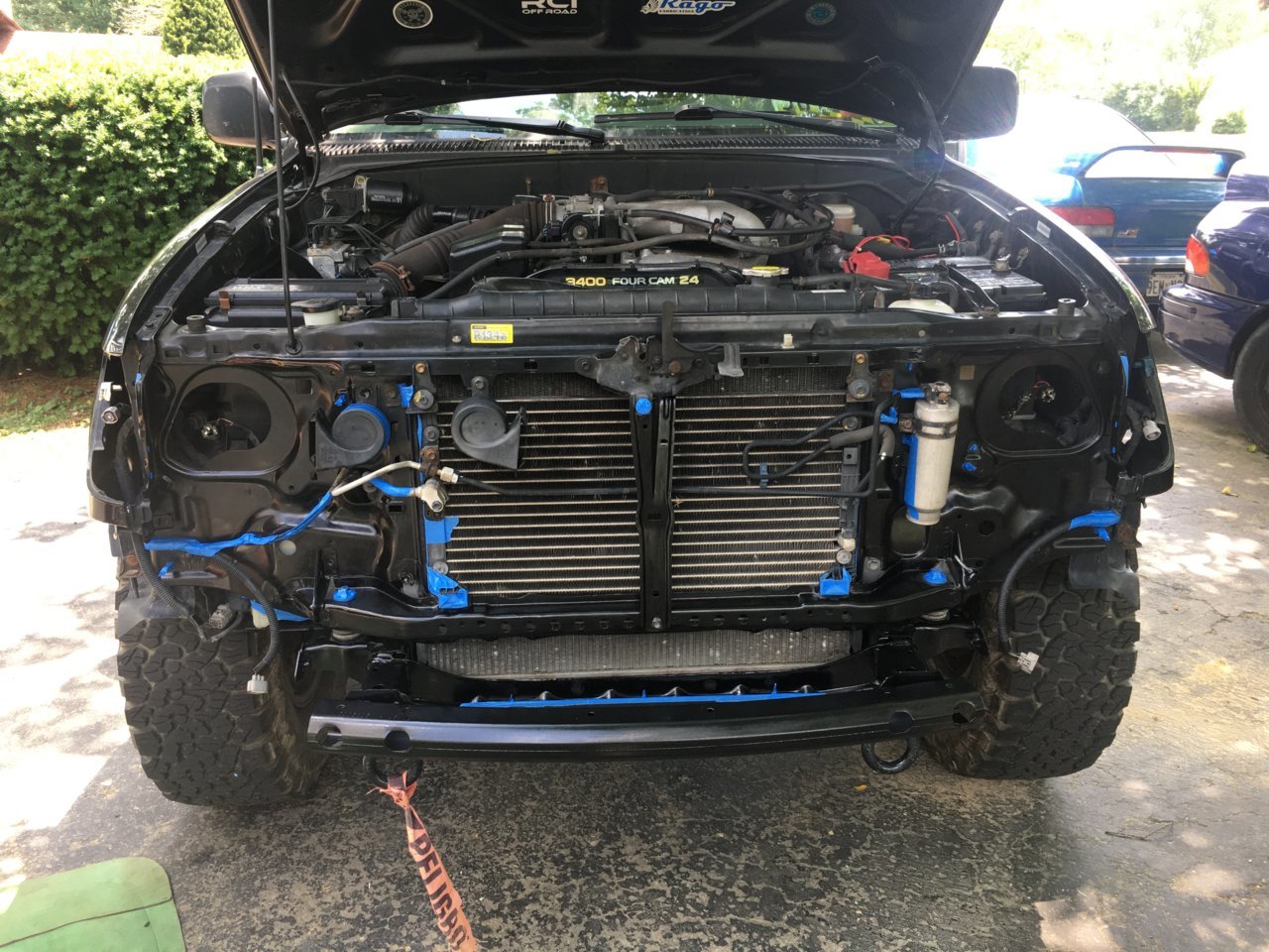

    @Cadmus, thanks for posting this thread. I too have been debating a similar situation. I have a truck with a year old replacement frame. Only protection is the oem flat black “finish”. I want to do everything in my power to protect and preserve the frame.
    I have settled on hand painting the frame this summer with Chassis Saver (or Eastwood) followed by a FF treatment in the fall. I figure now is the best time to establish an extra layer of painted protection before Fluid Film enters the picture.
    That said, I may have cheated the start with some Rustoleum enamel paint. I recently started on a headlight replacement project that quickly snowballed. I decided to paint all of the the forward facing metalwork for added protection prior to reassembling the front end. I don’t know how much good it will do, but figured something was better than nothing.
    This is a picture of the second coat of Rustoleum I did this afternoon.

  19. Jul 4, 2020 at 9:18 PM
    #59

    Wow. So clean!!!!!

    Thank you! But, looks are deceiving. I spent a LOT of time cleaning it. I started with washing out all of the dried mud that I foolishly stuffed up there by, you guessed it, running through mud on purpose.
    After the mud was rinsed away I degreased it, washed it, scuffed with Scotch bright, washed it again, rubbed it down with Acetone, then finally, paint.
    I felt crazy and it was a lot of effort, but they say painting is all about the prep. I took it to heart. Hopefully, the effort was/is worth it.
