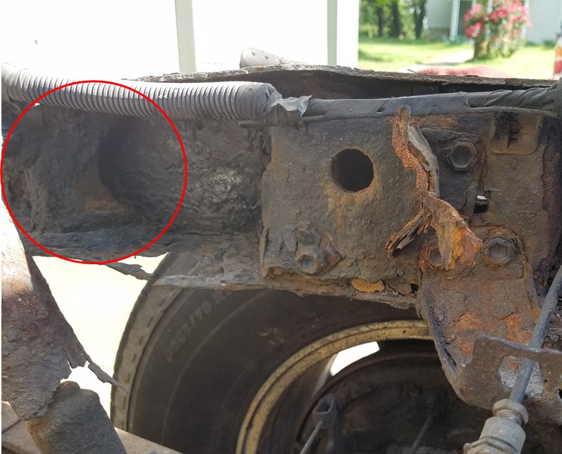

    I'll definitely concur! I just replaced my left with a brand new one, and patched my right. The right side on my Dad's truck broke off due to excessive rust. I sealed the front on mine with some rubber roofing "peel and stick" that I got from a brother-in-law. The stuff is amazing. It's pliable and has adhesive that obviously is made to resist water (roofing mat).
    Left and right sides had significant dirt/rust accumulations inside.
    Left before and after:
    Sorry, not so good pic, but the front hole sealed with rubber:
    Material used:

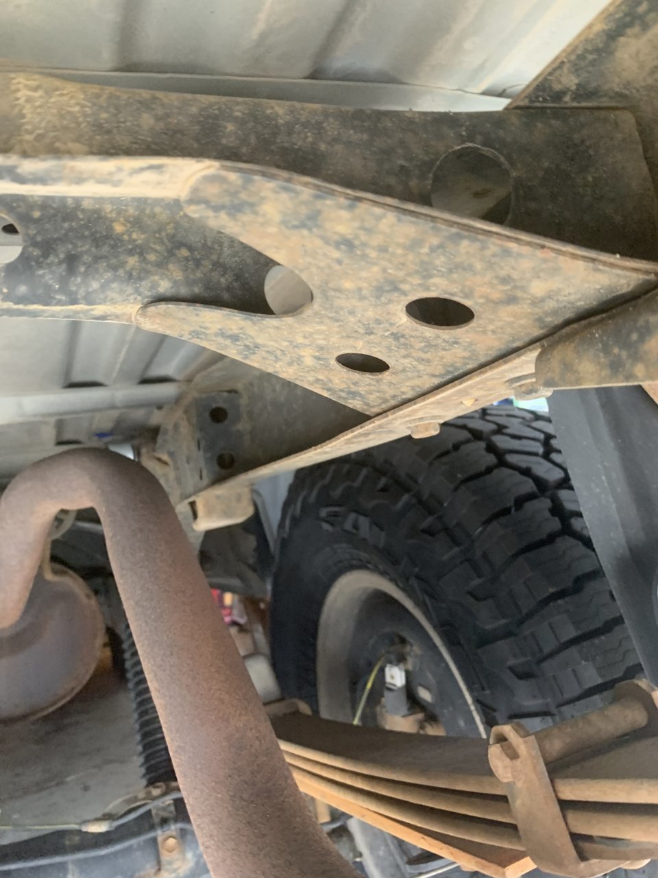

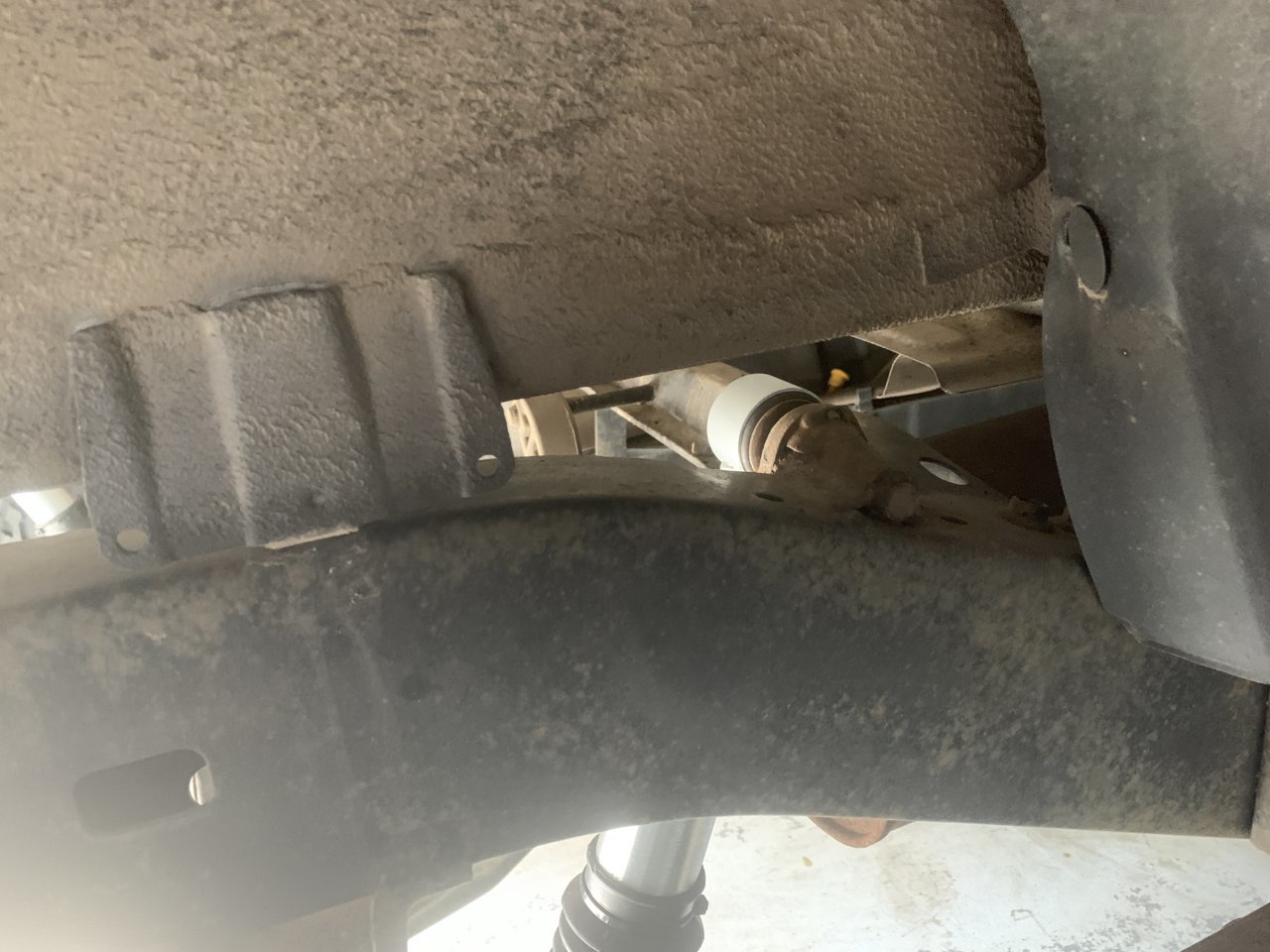

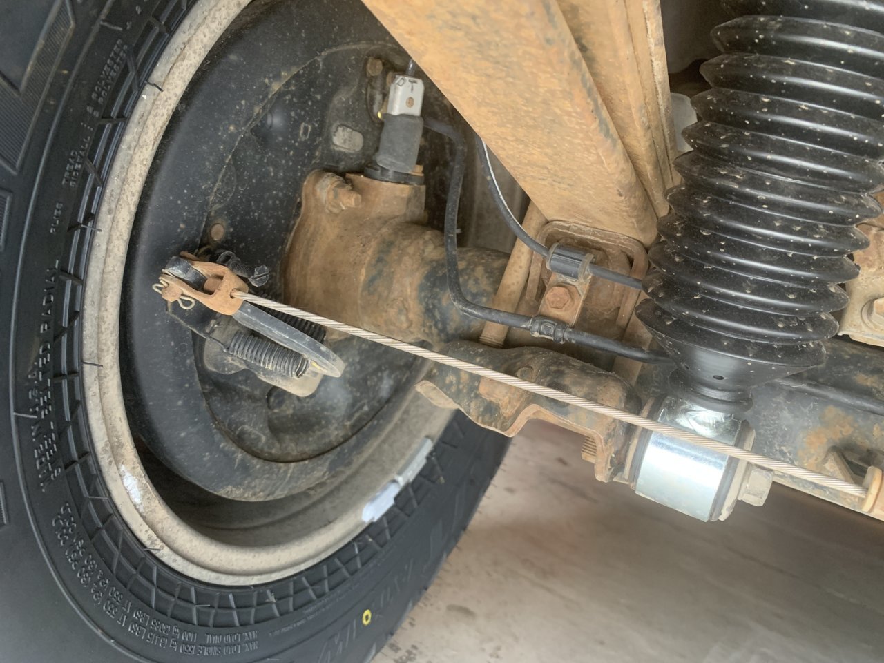

  4. Jul 5, 2020 at 5:22 PM
    #64
    yourrealdad
    yourrealdad Well-Known Member
    Aug 13, 2015
    #161668
    249
    Colorado
    2007 Red Tacoma DCLB TRD Sport 4x4

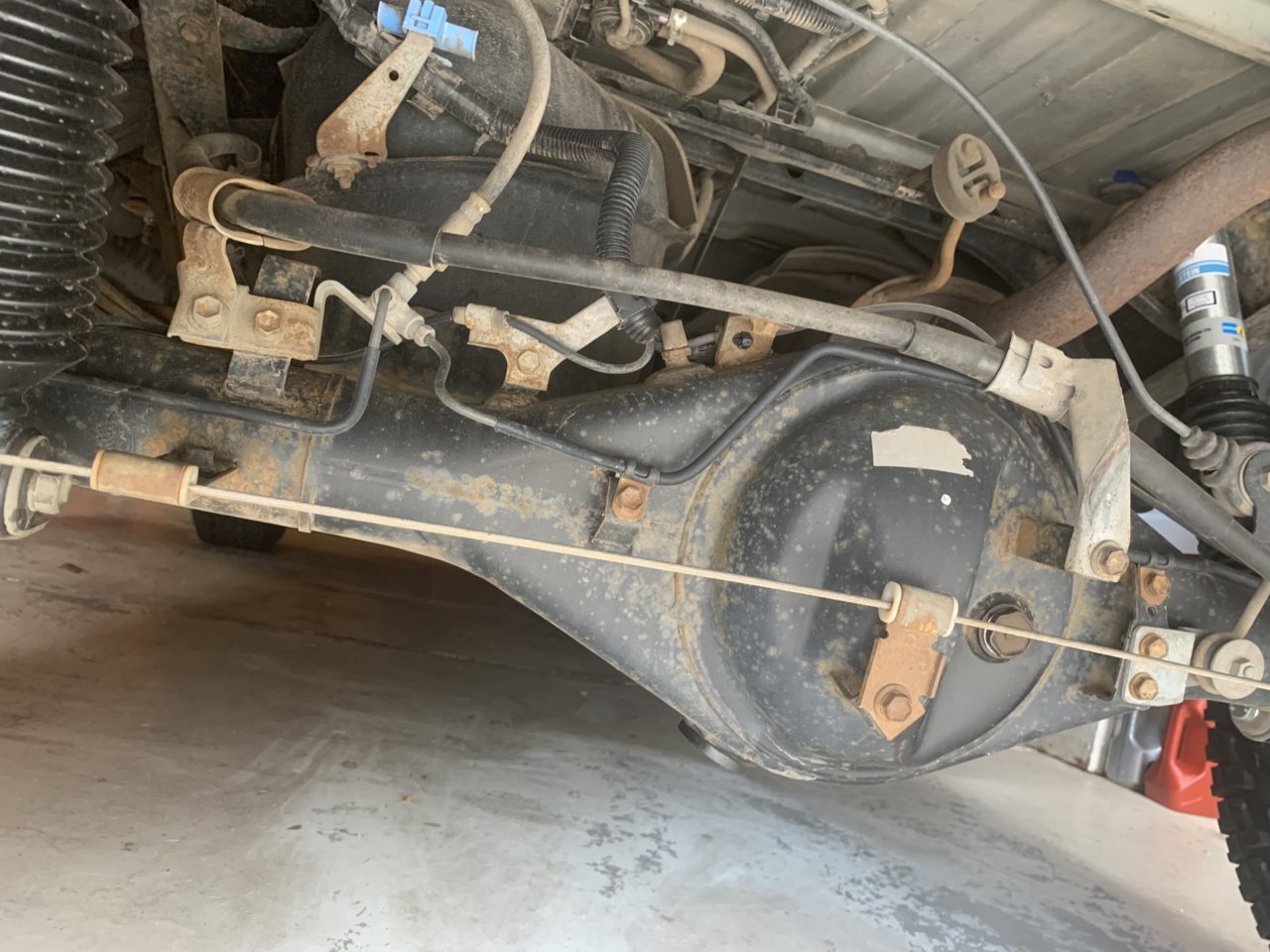

    F1A40C74-ADA6-47F6-BAC5-D8E21963DB1C.jpg F8ED5C2E-81EE-480E-9C12-D24569AAD61A.jpg 17379F91-E9A0-4C23-A07B-B386B7B18B43.jpg 128BA7F6-70FA-42B1-8C43-D8D7BF9D4B51.jpg 029D8247-1839-4684-A3B5-C40D9F46EE7F.jpg AFCAA8D9-9C17-4288-B1B4-C6A59B67AC68.jpg 15E488A1-618C-42C7-B5D3-CA58835CEEDE.jpg E04F4C73-3782-4428-BCB1-DDD6DC21BDBE.jpg 324A378A-B614-4DE3-A080-DC76846CB4DE.jpg

  5. Jul 5, 2020 at 6:11 PM
    #65
    GQ7227
    GQ7227 mw survivor
    Dec 6, 2018
    #275019
    29,298
    J A Y

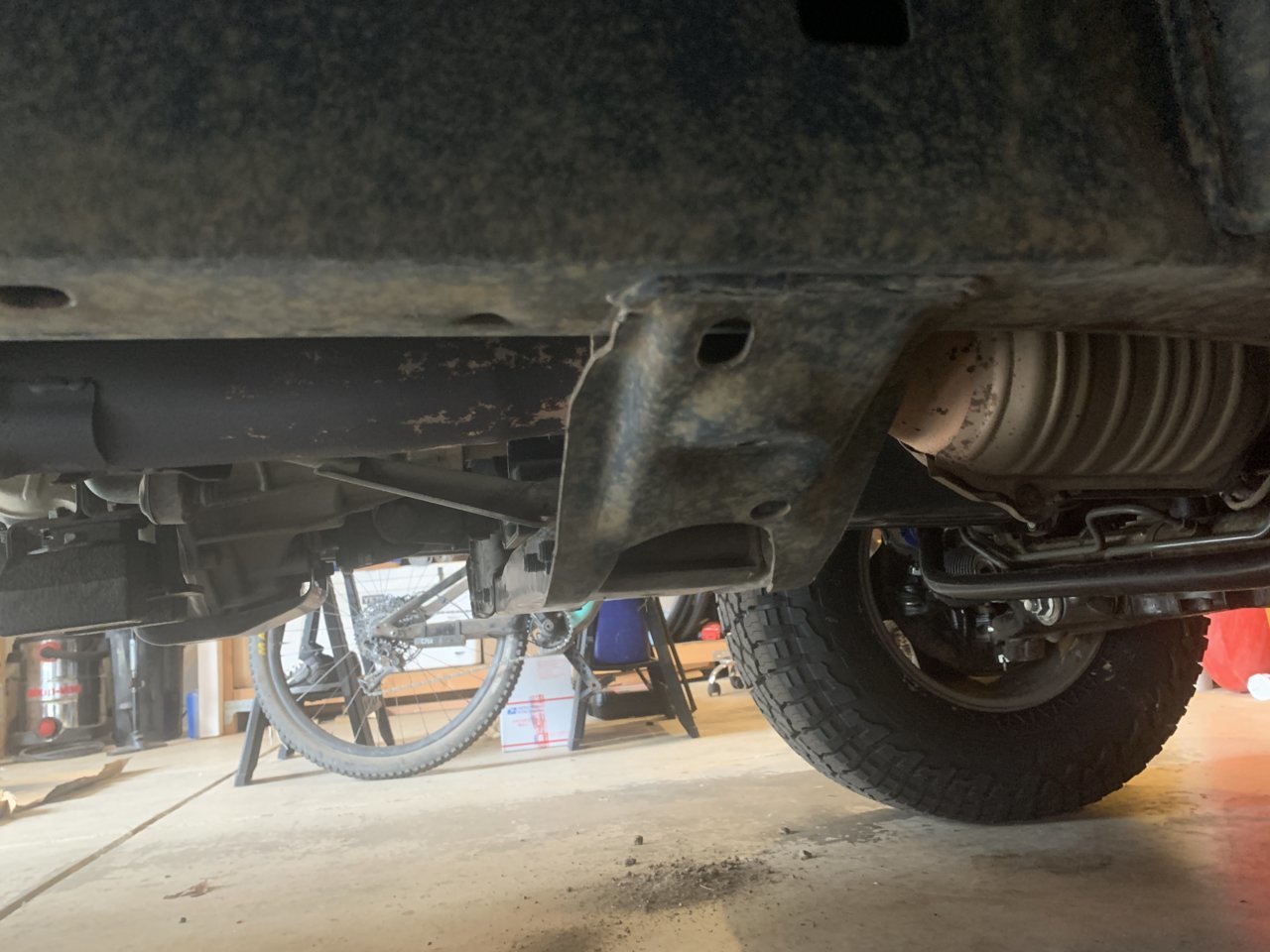

    i was not aware that CO has so much rust! i thought they are rust-free & no worries
    is a lot of the frame paint coating left real flaky?, not sure why its not black like mine is, or is it all just brownish dirt on there?
    most of mine in spots is bubbling under the paint but there are flaky parts by the spare
    FF will likely turn most of that black as you wanted?
  6. Jul 5, 2020 at 6:16 PM
    #66
    yourrealdad
    Aug 13, 2015
    #161668
    249
    Colorado

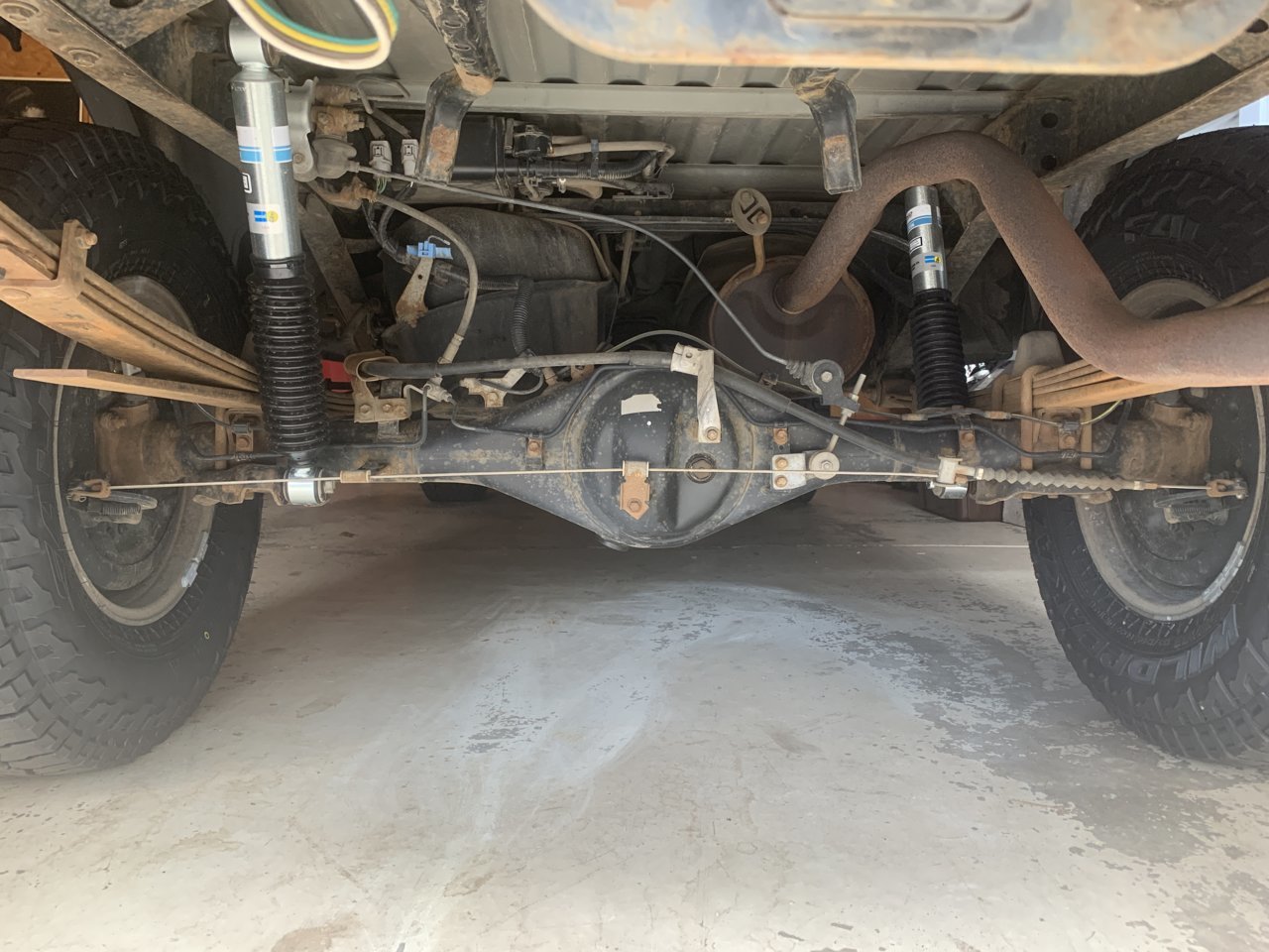

    It apparently spent a lot of time in CA so maybe right by the beach boyi.
    I think it looks pretty good honestly for a 17year old abused truck.
    the frame painting is all there and is not flaky it is solid and black. Where are you seeing otherwise?
    Again my only worry spots are around the leafs.
    So just go with some CS or Eastwood?
    GQ7227 likes this.

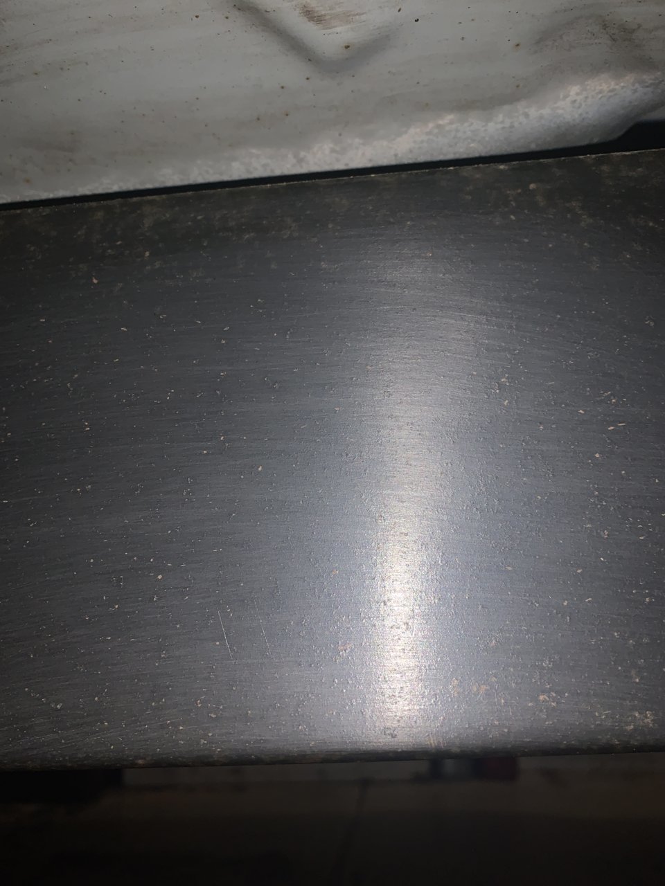

  7. Jul 5, 2020 at 6:19 PM
    #67
    GQ7227
    GQ7227 mw survivor
    Dec 6, 2018
    #275019
    29,298
    J A Y
    if you wipe off that brown stuff with some WD-40 it will look more like this then?
    i do not know if this is bad primer showing or rust on mine, i was told one thing believed another yada yada,
    it just appeared last year
    light source is halogen floor lamp

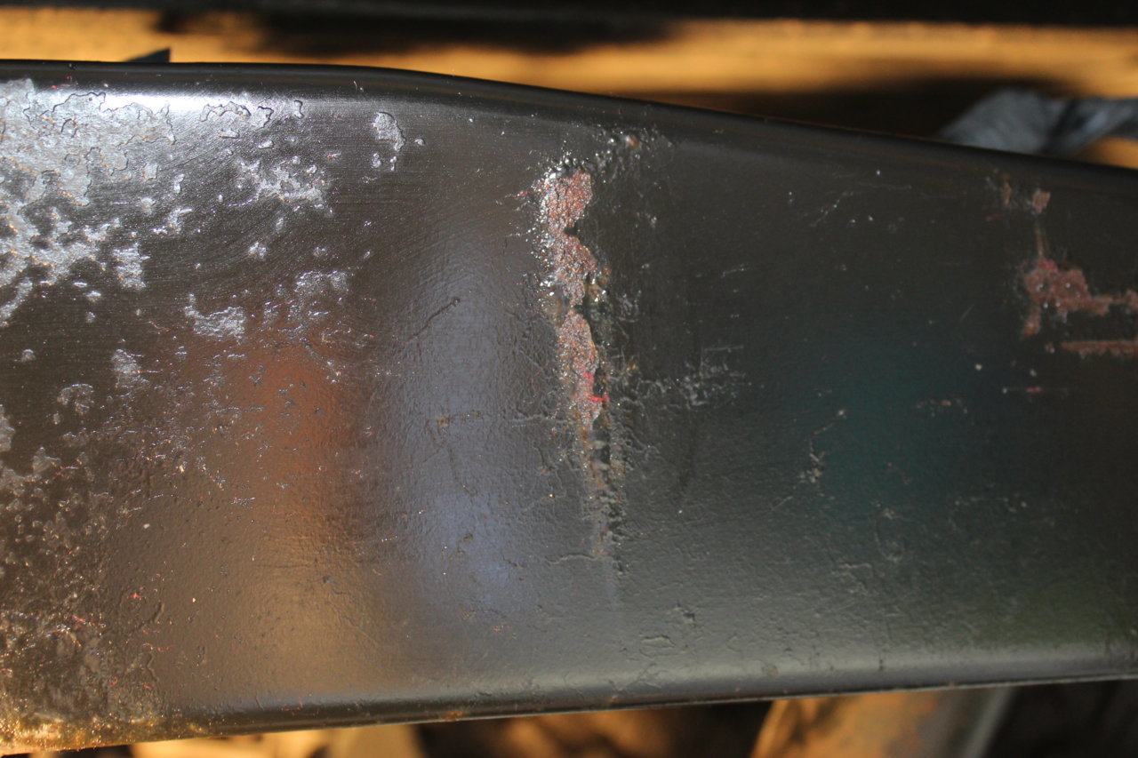

  8. Jul 5, 2020 at 6:37 PM
    #68
    yourrealdad
    Aug 13, 2015
    #161668
    249
    Colorado

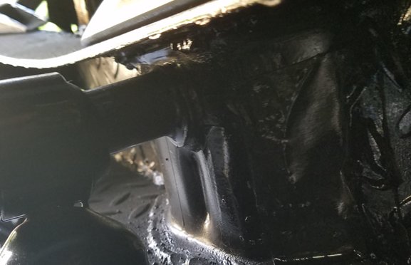

    05E86A40-5BB4-4434-BF64-3D515FEBC561.jpg CCB1D74E-5533-4600-8962-3D79028EB493.jpg Top pic is just a WD-40 wipe down. Second is after a Scotch Brite rub.

  9. Jul 5, 2020 at 8:16 PM
    #69
    yourrealdad
    Aug 13, 2015
    #161668
    249
    Colorado

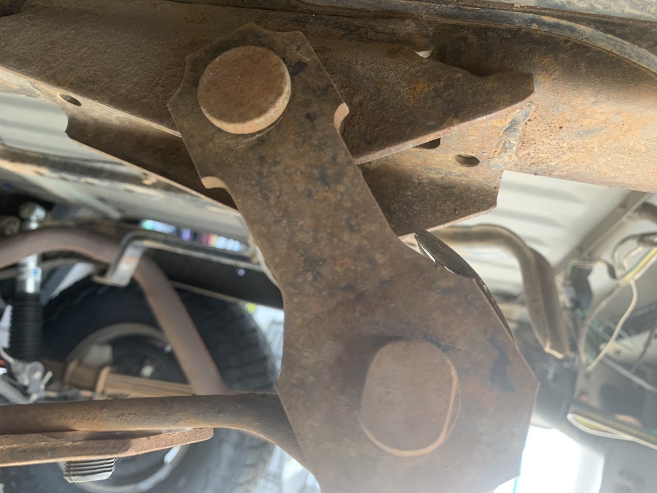

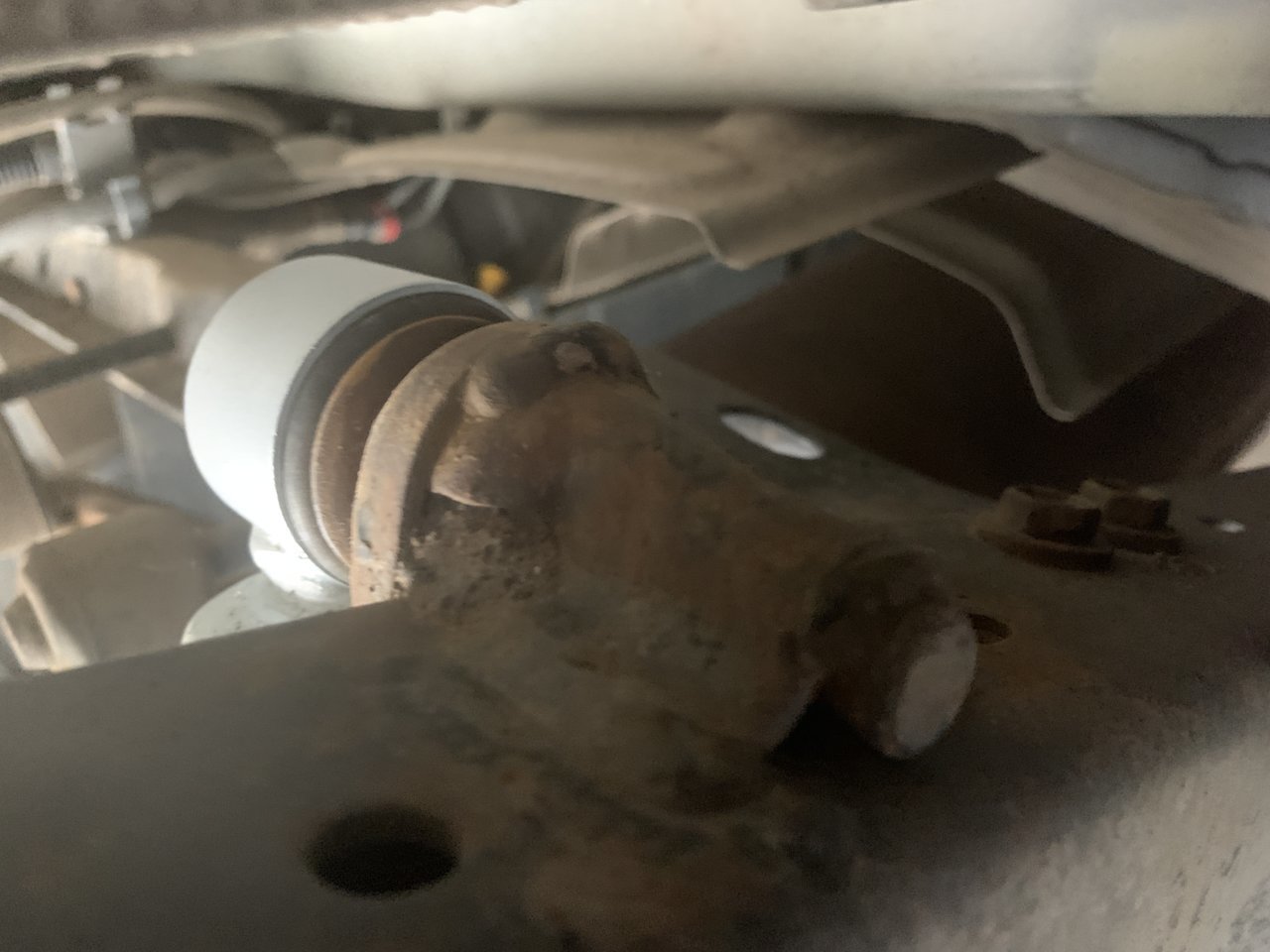

    Ok it sounds like CS needs rust to adhere to kinda like Eastwood's converter. So here is what I am thinking.
    Wire brush
    Apply Eastwood Rust Encapsulator on outer parts so I get that nice new looking black
    FF film the inside of frame because it is cheaper than Eastwoods and I can't see inside so who cares
    Does this sound like a good plan?
  10. Jul 5, 2020 at 8:17 PM
    #70
    onakat
    onakat Well-Known Member
    Jul 2, 2016
    #191075
    1,675
    Canada
    2000 indestructaco!
    wow! you are worrying for nothing. This is surface rust really. You'll probably be dead before that frame rusts through (provided it does not see winter salt or salty water)
    Don't even need to wirebrush or repaint. Just a layer of fluid film inside and out will do
    NSDON and cruiserguy like this.

    I see, I see...
    What is that stuff on the left, sticking to your frame? Looks like an old layer of paint
    But then that bubbling area in the middle, it is strange because it looks like rust but it is bright red underneath... and rust is not bright red
    You sure the frame wasn't repainted in the past?

    IMHO this roofing stuff will loosen up over time and then will hold moisture under the loose bits and will rust through , it would be better to scrape off the flakes and spray heavily with FF.
