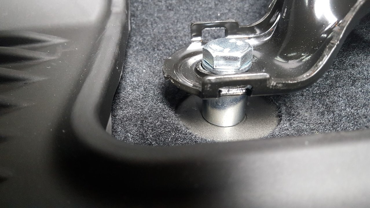

  6. Mar 27, 2016 at 3:38 PM
    bangin4WV
    bangin4WV [OP] Well-Known Member
    Mar 18, 2016
    #181659
    351
    Rocky
    WV.
    2016 SR5 2.7 MGM ACLB
    33s/sliders
    Raised the back 1''. I like it but have to figure something different for the trim piece. Any thought's?

  7. Mar 27, 2016 at 3:59 PM
    SOCO Taco
    SOCO Taco Well-Known Member
    Mar 19, 2014
    #125704
    120
    BSR
    Pueblo County
    `16, SW, DBL, Short, 4X TRD Off Road
    Brilliant. I was thinking about an inch on all corners of the seat to maintain the seating angle. Did you notice any problem with the seat angle since you only raised the back?
  8. Mar 27, 2016 at 4:00 PM
    bangin4WV
    Mar 18, 2016
    #181659
    351
    Rocky
    WV.
    33s/sliders
    No, so far so good!

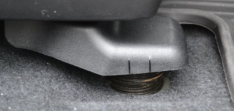

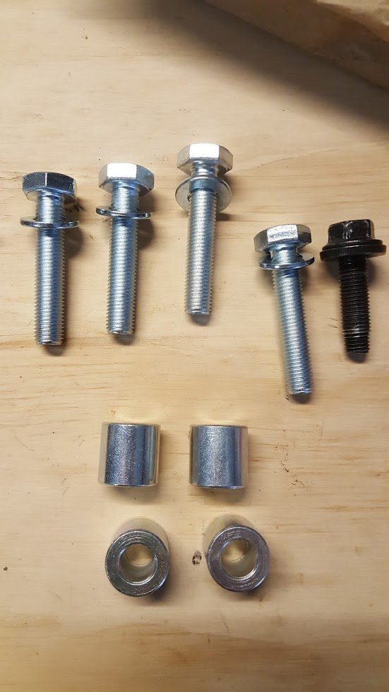

  13. Mar 27, 2016 at 7:51 PM
    nnj86
    nnj86 Active Member
    Oct 20, 2015
    #167248
    25
    Bryan
    North Jersey
    2016 Manual Inferno DCSB TRD O/R
    I'm 5'6 as well and found that one seat and backrest position was too far forward while moving each back one click made it too far away. I got fairly comfortable but that's not exactly ok with me when I'll be sitting in that seat nearly every day of my life for as long as I have the truck.
    Did the same thing, went to the hardware store and bought four bolts that matched the factory seat bolts but were about 2 inches longer and 8 nylon washers/spacers that were probably 3/4 inch thick each. Put two washers under the rear seat rails on both sides for both the drivers and passenger seats and used the longer bolts in the rear of rails. I also bought some thinner washers/spacers to fine tune the seat position but I think I hit the sweat spot already. It's a night and day difference for me.
