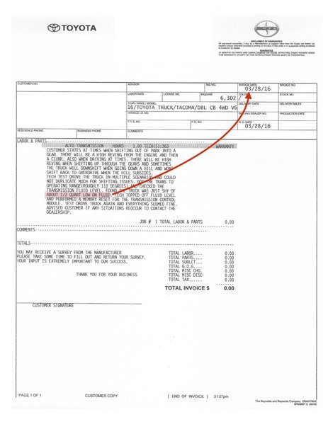

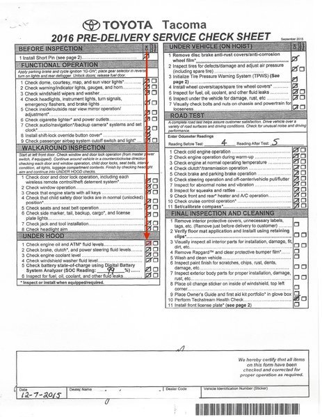

    This post isn't necessarily in direct response to Jin's post, but a response for all TW readers. After my experience with Toyota and their customer service, or lack thereof, in response to my former 2016 Tacoma's myriad of issues, I have owned my last Toyota for the foreseeable future. That being said, if I knew someone that was going to purchase a new Tacoma I would STRONGLY urge them to demand the selling dealership perform an actual manual check of the ATF level before they signed any final paperwork.
    The 2016 Tacoma I owned for 8,500 short miles exhibited transmission issues, among many other issues, and the selling dealership would not check the ATF level. So I went to a different dealership and told them to check it, and if it was full I would pay for the fluid level check. Low and behold, it was low and I have a service receipt as proof. I drove from that dealership directly to the selling dealership and procured a copy of the Pre-Delivery Inspection Sheet that clearly indicates the truck's "ATM" fluid level (This paperwork uses a different acronym for the transmission fluid. Just another way for Toyota to deny they have an issue with the "ATF" fluid level in any of their vehicles) was OK.
    The fact is easily understood and clear. Either the dealership that discovered the transmission fluid was low lied, or the selling dealership lied when they stated the ATM fluid level was ok on the sell date. Not to mention a Service Advisor at the selling dealership stated my fluid level was "OK" when I accepted the truck back following a service appointment on 03/14/2016.
    Apparently the truck developed a leak between 03/14/2016 and 03/28/2016, when the transmission fluid level was determined to be low.
    At any rate, I STRONGLY suggest anyone . . . of the mindset they must have a new Tacoma . . . to NOT do so until it is proven the transmission is not low on transmission fluid.
