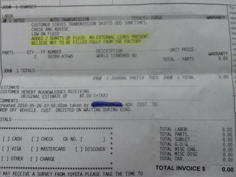

    image.jpg My SR 4 cyl auto transmission without a trailer pulling package was two quarts low.
    Arlington Toyota in Jacksonville Fl test drove it and without any excuses checked the fluid level.
    It would shudder when it shifted, but only sometimes.
    I was expecting a song and dance, but was pleasantly surprised by their immediate attention to my request.

    Redacted document. LOL.
    Glad you got good service.

    How many miles on your truck?
    Any negative long term impact, running the trans 2 qt low for extended period of time?

    The truck has 4500 miles on it. As far as damage, time will tell. I really don't expect any as it didn't happen frequently. It mostly happened between 3rd and 4th during the first shifts of the day.
    When it would happen, I would feel it and wonder.
    I crawled under and I could see the scuff marks on the check and fill plugs as well as a few drops of fluid.
