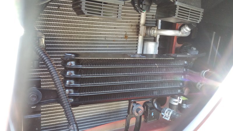

    #136
    Diego1931
    Diego1931 Well-Known Member
    May 6, 2016
    #186238
    280
    Northern Ontario
    2016 Tacoma TRD Sport Inferno
    Truxedo Tonneau Cover Lund 5" Nerf Bars Shear Comfort Neoprene Rear Seat Covers Wilson Cell Booster Custom Aux Fuse Panel Interior LED Upgrade Tailgate Pop'n'Lock Console Divider Goodyear Wrangler Duratrax 245/75/17 Dewalt Tool Box POD Brake Controller Frame Rust A/C Mod Husky Weatherbeater Floor Mats In Progress: Tool mount brackets in bed D-Ring Bed Mod Under Hood Lighting System Inverter Cab Install
    I think the Transmission cooler is the small rad in front of your main rad. Looks like a narrow lunch box.
