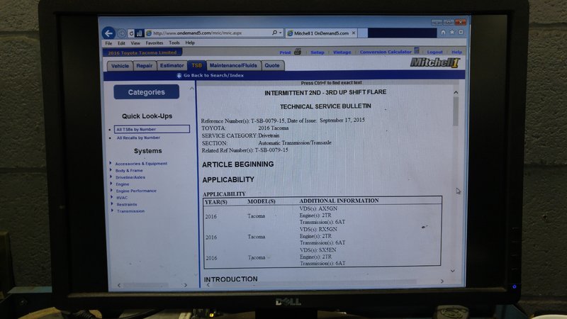

    That is for the 4 cylinder trucks only.

    It was issued in September of 2015 10 months ago. So not really a big deal since most trucks had this done before the customer ever took delivery.

    that is specifically for 2nd to 3rd shift problems
    not the same, not at all, as 'check for low fluid'
    this low fluid check has to be a PDI update which will only go to dealers and (do PDI's show up on techinfo ? I forgot)
