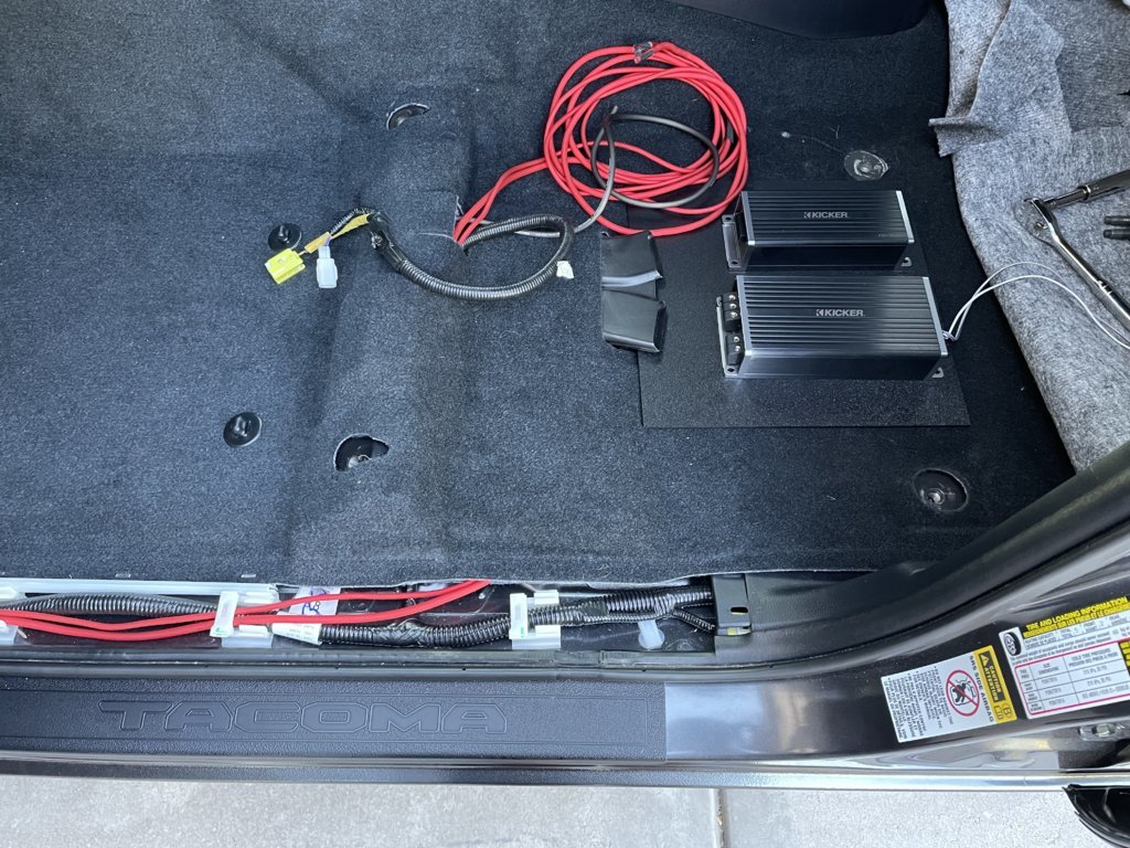

    Is an inline amp like the kicker key usually the simplest way to help balance out the rear speakers?
    Also where would the power cable for that usually be ran through the firewall at?

    Kicker key 200.4/500.1 here with focal rse-165 and rcx-165/jl stealthbox and oem head unit. The keys clean up/fix a lot. Improvements to rear speakers, but they're still not quite on the level I'd prefer. Sound quality is 10/10 with the DSP though. Planning on swapping in a Sony 9500es soon.
    Ground under/near the driver seat if you peel back the carpet. There's a grommet right next to the brake master cylinder. Snake the power cable under the drivers seat carpet and under/along the trim by the door and feed through the firewall behind the brake/gas pedals and through the grommet hole, along the drivers fender and to the battery.

    Do you have the amp placed under the drivers seat?
