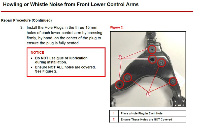

    "Introduction
    Some 2016 model year Tacoma vehicles may exhibit a howling or whistling noise from the front lower control arms at speeds of about 25 – 45 mph. The noise may be more noticeable when cross winds are present. Follow the procedure in this bulletin to address this condition".
    This fixed my problem, no more noise at all. Lower control arm plugs, 3 in each side. But like Steele-Taco said you can tape over the holes first as a test. Or you could take it in at your next service and have Toyota do the TSB.

    Recently bought a new 2017 OR 4x4 and just started hearing a whinning/whistle type noise - but could not produce a pattern it just seemed to vary. Yesterday I saw this thread and today I put 6 pieces of plain old duct tape on those six holes and all noise is gone. Drove it quite a bit and noise so far has not come back. I will soon get the plugs and fix it right. Thanks - this post fixed my noise issue.
