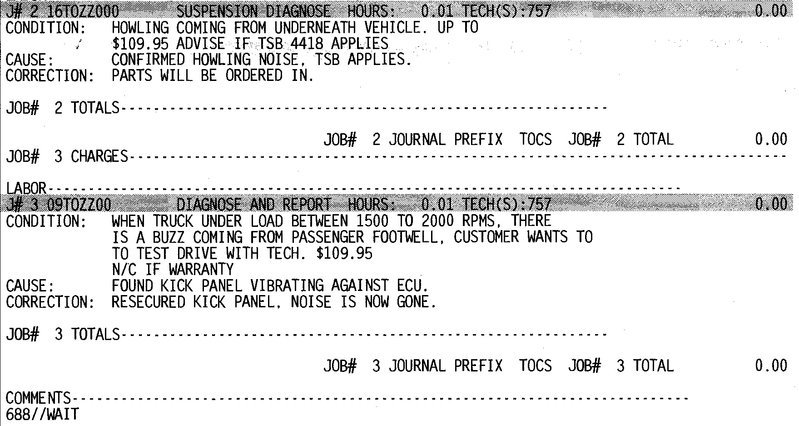

    I had the A Arm howl and a buzz from dash. Not a tic tic tic. Hard to diagnose the noise but two techs went out and one guy was upside down in seat until they found it. The tech referred to using a vibration and rattle kit. I picture the same stuff as you'd see on as pickup truck cap gasket between cap and bed rail. Here's what they wrote. Maybe this can help you out. It was getting worse and super annoying.

    If it's a tic tic tic however is it like the 2nd generation and the HVAC fan is making the noise? My 2nd generation had it. I just pulled the fan now and then and used graphite lube on the opposite side of the fan motor where the steel shaft didn't have a bearing. Would work for months at a time.

    Yeah, it's more of a buzz coming from the dash. Thanks for your answer!
