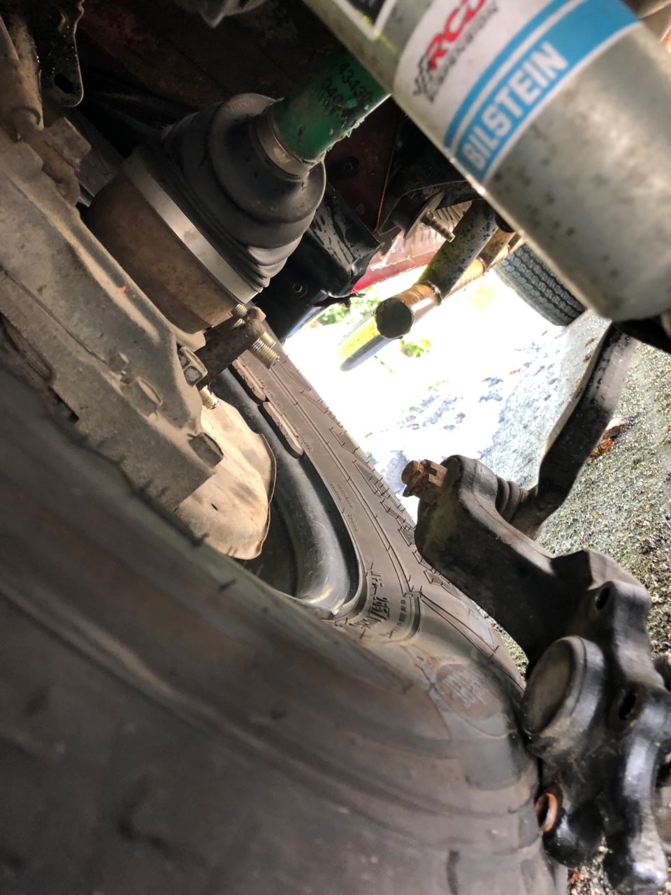

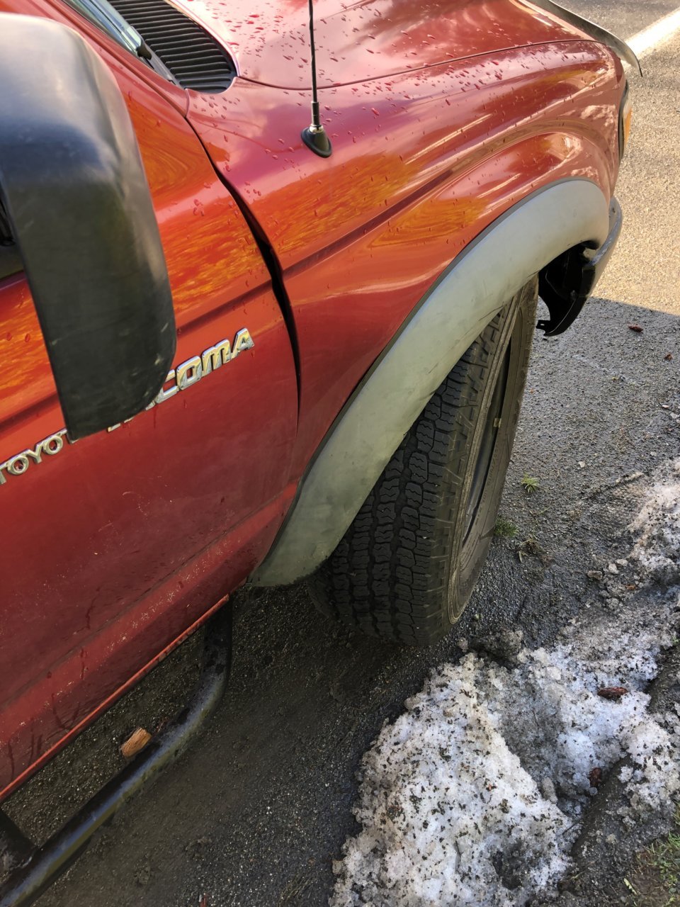

    They were ORM balljoint a to start and yeah autozone is junk most of the time I just needed the bolts so I bought the whole ball joint.
    Yeah the bolts were just gone. Top and bottom there was no sign of damage scratches or anything. No sign of damage on the threads of any kind.
    I feel like it’s installer error with not torqueing to spec. My only hang up is these OEM ball joints only have 3k miles on them.is there a possibility that is ordeal did internal damage that would warrant replacing it?

    2023 Tundra Pro
    Even if they look fine i wouldn't reused. :notsure:

    Azusa, CA
    I wouldn't reuse those original LBJs after a bolt failure like that, the ball joint could have been damaged inside during the failure when it hit/dragged on the ground, not a risk worth taking IMO

    Azusa, CA
    Also be sure to check for play in the ball joint itself, LBJs don't always fail at the bolts, sometimes the ball joint pops out of the socket esp on cheaper aftermarket ones.
    https://www.youtube.com/embed/rteeAOQlrKY
    That's for a 3rd gen 4runner but it's the same concept for checking them.
    These trucks have a shitty ball joint design to begin with, which is why Toyota reversed it on 2nd gen Tacomas after 2004 and you never hear of them having these issues.
    Our LBJs are consistently under force to be pulled apart, on 2nd gen Tacoma's it's flipped around so the ball joint is being pressed into the socket not pulled out.

    Jeez I don’t know, new motor 10k miles 3.5L lol, AFE intake, JBA headers, Gibson exhaust, rerouted exhaust B side soon to come, ABS delete, gray wire mod switch, dif drop, all pro upper a arms, all pro expedition leaf spring pack and shackles, bilstine 5100 front and back toytec eibach 1.6-3″ in the front, rolling 16” steels, front bumper off a dodge 2500, rear bumper made of wood 2x6 lol, interior carpet delete to all weather rubber floor insert, a bunch of other junk and a feckin ton of spray paint holding it all together. Second owner stock when I bought it first vehicle I ever bought I love this wip!
    It was a mechanic buddy of my that did the ball joints when I was super busy and couldn’t. I definitely have a torque wrench and I know he does too but if he used it is the question.
