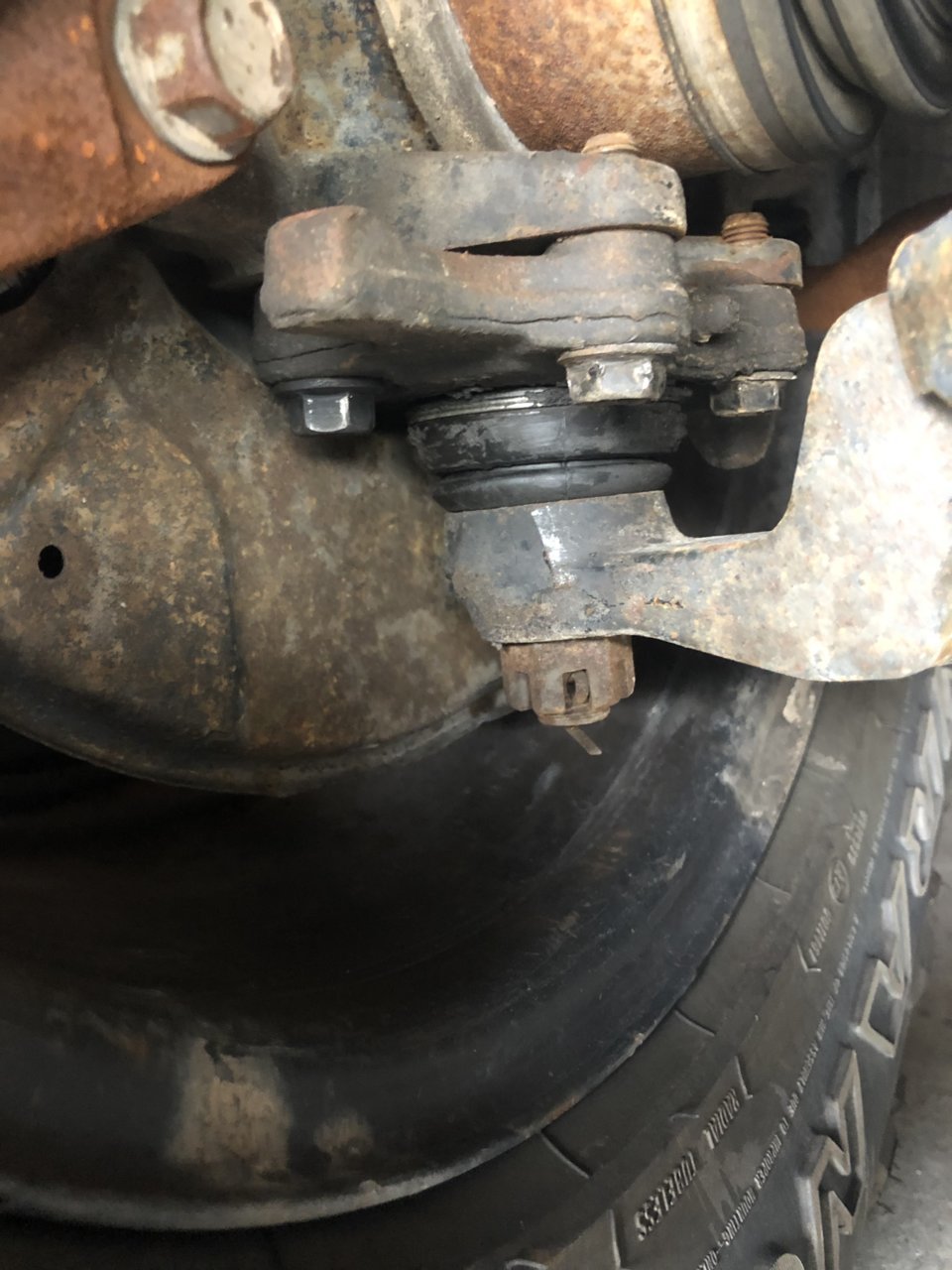

    Yeah, doubtful he did, and even more so that he didn't use locktite.
    Might warrant a quick "ya done f'd up" call to your buddy...

    Yep I checked it all this morning still feels fine with the old one in it only has 3k miles on it.

    Dude I probably should have waited to call hem cause I was flaming pissed when I did. Yep doubtful he did it right.

    HE was "flaming pissed" at you? WTF?
    I'll tell you this much. That shit happened to me, like it just did to you... after I saw the bolts FELL OUT of a critical companant like an LBJ... I wouldn't have called, I would have gone down to his shop. And they damn near would have had to call a fucking SWAT team to calm me down.

    Visually the ball joint looks fine and they have no play in any direction after falling off.
    No man I was flaming pissed at him, I lost it on him on the phone. he’s paying for new ball joints or were gonna have a big issue.
    Look at all that Cali rust ugh!

    They didn't come with the dust boot covers? I don't think it's a critical component but mine have a square rubber cover that wraps around the grease filled boot you see there.

    Are those the LBJs that were (supposedly) replaced 3000 miles ago?
    If so, me and that guy would have major problems. I replaced my LBJs over a year ago and don't look like that. The LBJ bolts have WAY more rust than they should, that castle nut does not appear new, and that cotter pin doesn't either.

    No way I believe LBJs look that way in 3000 miles anywhere in CA.
    Maybe it's true... no way I believe it.

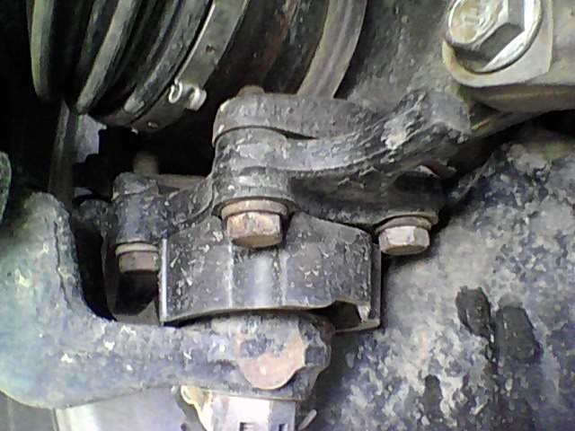

    That's what mine look like (just took the picture right now) They were installed a year ago. Mine are 555.

    Must be an OEM thing on the later 1st gens.

    This is about what my 555's look like after a little more than a year. It's just a little surface rust. I'm not worried about that.

    Oh, I'm not saying that surface rust is a problem. I'm saying I don't believe there's a place anywhere in CA that rust would occur to that extent in 3000 miles.
    But then again... 3000 miles happens in a month for me. I don't know how much that truck is driven. Could be 6 mo, 12 mo. I don't know.
    But those LBJs don't look like they've been replaced anywhere near recently.
    Not to me anyway... maybe I'm way off.
