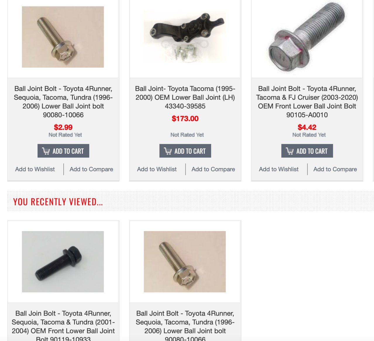

    why are there so many different ball joint bolts that fit our Tacomas. Also which is the right one ?
    While back I ordered some bolts from toyotapartsdeal.com
    and I am confused
    the 90105-10406, and 90105-10505 say they are for ball joints
    so does 90080‑10066
    they all look the same except or the 10406 (black color bolt)
    but size and thread all the same
    here is image example of all the ball joint bolts that fit our make model

    There were some iterations where 2 bolts were slightly longer than the 2 on the opposing side of the same lower ball joint.
    Then, there are revisions to part numbers which essentially are the same part, but manufactured by someone else (happens often in the automotive industry).
    And my statement about my signature was simply an alternative to buying bolts and LBJ's separately in the event that you were shopping for said items. I recall reading multiple posts recently in the above mentioned thread (you included) about replacing LBJ's.
    The part numbers in my signature include the required bolts with the LBJ's.

    His signature has the LBJs with bolts part numbers. There is a left (driver) and right (passenger) part number as the
    ball joints are different.
    If you are looking for just the bolts:
    There are two LBJ bolt part numbers from Toyota. One has the washer built in to the bolt (flange bolt, preferred one to use) the other is a bolt with a separate washer.

    I strongly suggest that you find the part numbers using your VIN number on parts.toyota.com and then find those part numbers on your internet part provider of choice. I've found toyota parts deal parts fitment to not always mirror the parts.toyota.com diagrams. But anytime that's been the case, I default to parts.toyota.com, and I've never gotten the wrong part.

    They are not all the same, the earlier type were washer bolt heads (1995.5-2000). The 90119-10933 are regular bolts with washers locked into the bolt, which is for 2001-2004 so your truck. The earlier bolts without washers also fit but have different torque specs.

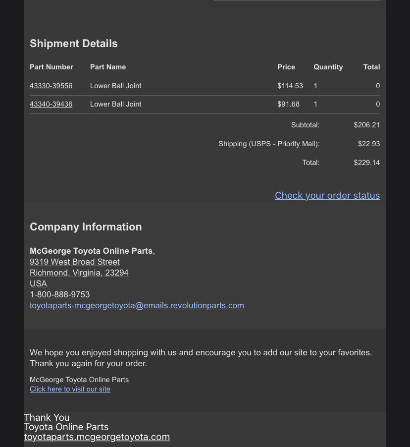

    LBJs advertised to fit 01 - 04s do not come with bolts, they have to be ordered separately.
    The bolts that come with the earlier years' LBJs are slightly different and might not work with the rubber dust boot that the 01 - 04s use, since the dust boot attaches using 2 of the LBJ bolts. The dust boot effectively shortens the two bolts it uses that attach it.
    I would stick with the LBJ part number that is advertised for 01 - 04 if you have that year.
    Attached my last order screenshot, for the LBJs and the bolts (separately)

    It's so weird. When I ordered my 01-04 LBJs from McGeorge I was under the impression that I would need to order the bolts separately. But when the LBJs arrived the flange bolts were included.
    Here are _McGeorge Invoice w Part Numbers.jpg the part numbers:

    The question would be, the part number on the actual tags for the products received.
    McGeorge if I recall correctly, sells parts that are supplied from multiple dealers if they themselves don't have it in stock.
    I've received the wrong parts before when I ordered a ton of bolts, seals, drain and fill plugs and more.
    Turns out, one of the plugs that I got (wrong part) was from a 100 series LC but works on the Tacoma as well. Just had a longer magnet.
