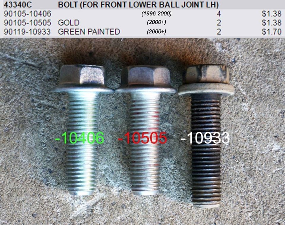

    The difference is because the earlier Tacomas did not have a boot that covers the LBJ so they used a flanged bolt. In the later years they introduced the black bolts with a washer because they added the LBJ boot. If you tried to use the early flanged bolt with the boot, it will start to tear the boot as you torque it down. From my understanding, the boot isn't really necessary anyways.
    There are two difference torque values listed by Toyota. If you have the earlier flanged bolts, they are supposed to be torqued to 59ft/lb and if you have the black bolts with the washer, they are supposed to be torqued to 37ft/lb. I replaced mine with the flanged bolts and used 59ft/lb. Some disagree and say to use 59ft/lbs for both bolts.
    https://www.mighty90s.com/forums/di...j-bolts-and-why-its-important-prado-90-series
    I tried to replicate the findings in this article and didn't get nearly the same stretching that they found. Some of the black bolts didn't stretch at all and some was very minor...about 1 tooth stretch. The flanged bolts didn't stretch period. Make sure you use grade 10.9 bolts. The choice is yours.

    I actually 3 variations of the bolts. Flanged are shorter for sure

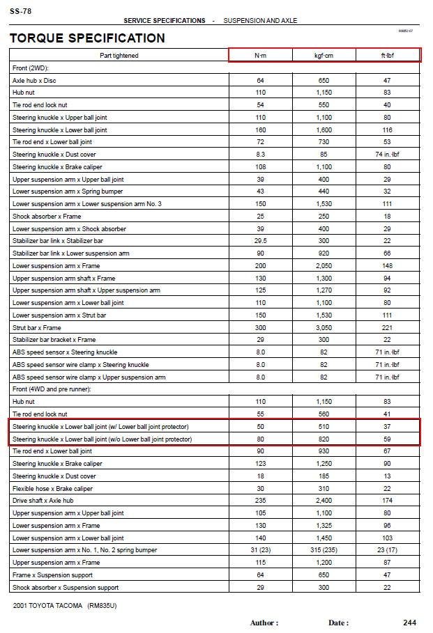

    Andy,
    The 2001 FSM I have does list (2) different torque specs: 59 ft.-lbs. for the flanged bolts used with no LBJ Protector and 37 ft.-lbs for the longer black bolts used with the LBJ Protector. The general consensus is that the LBJ installation itself is stronger when NOT using the LBJ Protectors with the longer black bolts. If the torque spec on the longer black bolts was the same, I would retrofit the LBJ Protectors to my '97 Taco 4x4 for the added protection offered to the LBJ boots. .02
    2001 TACOMA FSM table SS-78 from here: The different LBJ bolts and why it's important, Prado 90 Series — Mighty 90s Forum. I verified that this is a copy of p244 in my 2001 TACOMA FSM.

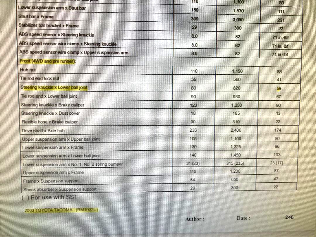

    Andy,
    The FSM for your 2003 TACOMA 4WD only lists 59 ft.-lbs on the torque spec just as you stated. I would use what is in print in the FSM for your 2003 TACOMA 4WD. Given that data, I may eventually retrofit the LBJ Protectors to my '97 TACO and torque the longer black bolts 90119-10933 to 59 ft.-lbs.
    EDIT: Question for you on the bolts used on your current LBJ with Protector: Are all the bolts the same longer black captured washer bolts seen below as 90119-10933?
    Different LBJ Bolts: The different LBJ bolts and why it's important, Prado 90 Series — Mighty 90s Forum
    FSM 2003 TACOMA 4WD p246 table SS-78:

    At least some of the bolts on my truck appear to be the captive washer type, but until I remove them all (waiting for parts), it will be hard to tell if they all are...looks pretty crusty right now. In the meantime, I have ordered both types of bolts and am contemplating whether or not I should reuse the LBJ protectors and which bolts to use. This will depend on whether the LBJ protectors are serviceable (they're at least 15 years old) and what type of bolts I end up removing. Part of me thinks the simplest approach is to omit the LBJ protectors and use the flange bolts torqued to 59 ft-lbs.
    The remaining inconsistencies are that the 2003 FSM specifies 59 ft-lbs and doesn't show the LBJ protectors, yet the dealership parts guy specified the captive washer bolts, which apparently should only be torqued to 37 ft-lbs (unless we favor the 2003 FSM over the 2001 edition). I'm getting the sense from users in other threads, as well as the inconsistencies between the 2001 and 2003 FSMs that there are likely to be a few combinations of bolts, protectors and torque values that will suffice. Many users just used the flange bolts torqued to 59 ft-lbs, with or without the protectors, while some used the captive washer bolts, torqued either to 37 or 59 ft-lbs. Maybe I'll just cut the bolt hole "ears" off of the LBJ protectors and glue the protector to the bottom of the knuckle with RTV, and use the flange bolts torqued to 59 ft-lbs. Seems like this way I would get the protection and avoid the bolt length and torque issues.

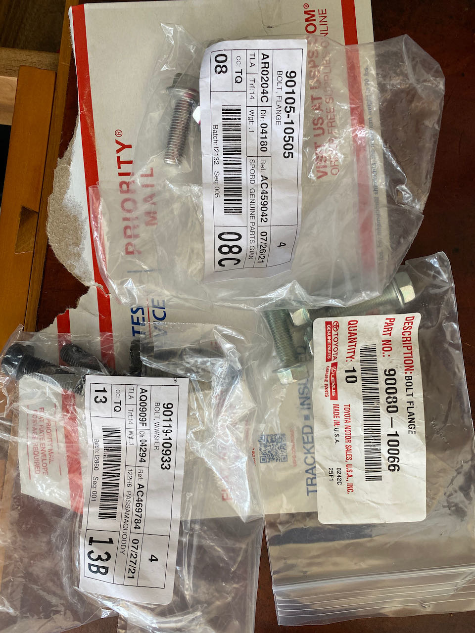

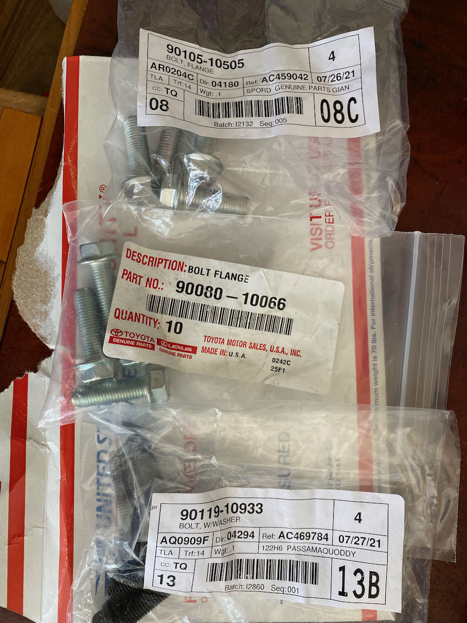

    Hey guys,
    My 4 wheeling/hunting season will kick off in just days now and will be non-stop until June of next year. I had some free time today. So while the TACO is all cleaned up, I retrofit the LBJ Protectors to my '97 TACO. While doing so, I took measurements with a dial caliper of just how much these bolts stretch. You only need to use (2) of the longer black bolts 90119-10933 per LBJ Protector at the (2) attachment points. It appeared that you can use either a shorter flanged bolt or a longer black bolt with washer for the other 2 attachment points. The blind threads in the knuckle appeared plenty deep enough when I probed them. And I noted no interference with the LBJ Protector from the flanged bolts that do not attach the LBP Protector. Here is what I measured as far as bolt stretch:
    1. The OEM shorter flanged bolt 90105-10406 was measured as installed in the knuckle @ 59 ft.-lbs. It was 0.004" shorter when removed so it stretched at least that amount on installation, most probably several 0.001"s more.
    2. The OEM longer black bolt 90119-10933 used to attach the LBJ Protector stretched 0.0065" when torqued to 37 ft/lbs.
    3. The same OEM longer black bolt 90119-10933 stretched to 0.0075" when further torqued to 59 ft/lbs. So the increase in torque from 37ft/lbs to 59 ft/lbs only resulted in an additional 0.001" of stretch in that bolt.
