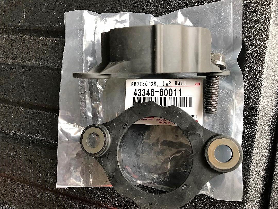

    Even with the 2 attachments points broken off, the Protectors should still do their job protecting the LBJ grease boot. A few dabs of Permatex Ultra Black on the upper side would do just about as good a job securing them as the 2 attachments which look to be just washers bonded into the LBJ Protector boot.

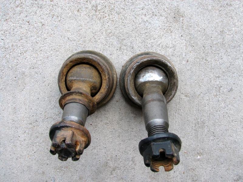

    That is just about the same thing I saw on the original OEM LBJs on my '97 TACO when I changed them for the first time in 2013. Even after 16 years of severe service, the LBJ boots were still good with no pin holes and both LBJs torque-tested to be serviceable. But the OEM UBJs were toast (below); very lucky they did not fail on me. I changed all the BJs out at the same time in 2013 just to check that box. The OEM LBJs & UBJs cost more but they are well worth the extra cost to me especially given the known problems with the 1st GEN TACO LBJs.

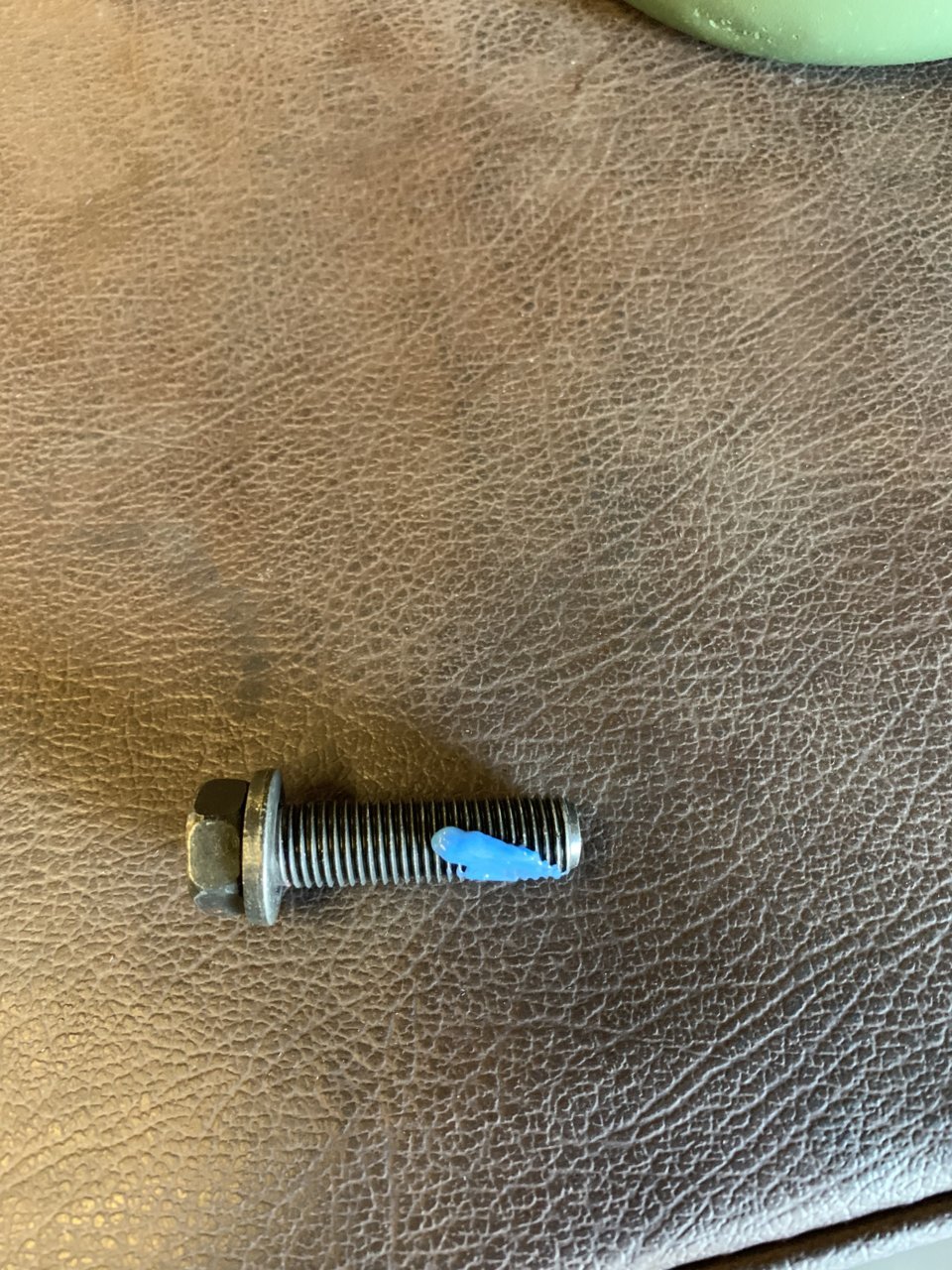

    I replace mine back in June. New bolts and new boot protectors. I went with the shorter flange bolts up front/inboard, and the longer captive washer black bolts in the back/outboard. Little bit of blue loctite on all four bolts, and all torqued to 59ft lbs. Everything was OEM.
