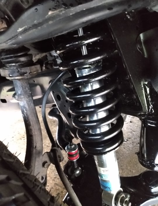

    I can't tell specifically from your picture, but you may want to use this an an opportunity to freshen up some of the worn bushings that are like the red ones in this picture. Its easy to get caught up into spending a bunch of money on suspensions. Its a fun way to drain your wallet.
    Though that's the one area where I get to feel improvements with each modification.

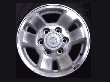

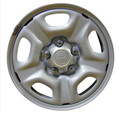

    The number of lug nuts on the wheel. This wheel is for a 5-lug Tacoma.
    This wheel is for a 6-lug Tacoma.
  15. Oct 6, 2019 at 6:43 AM
