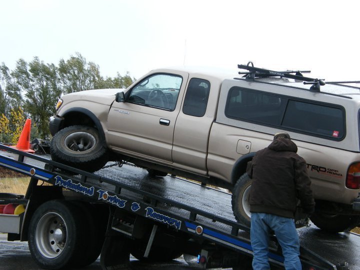

    The maintenance interval is 100,000 miles. Change them with OEM parts. Don't be this guy:
    Tacoma-JB, 970btu, Kiloyard and 6 others like this.

    Or worse - seriously. Is it really worth a couple of bills? Absolutely. No skimping on new bolts either.

    is there any type of 'warning' before something like that were to happen and you need to pull off the highway for safety?
    any wobble in the steering or abnormal noise?

    Nope; when it goes it just goes.
    The only warning is doing a physical and visual inspection as stated above.
    I replaced mine just because; I consider it maintenance. If I have to question it, I replace it.
